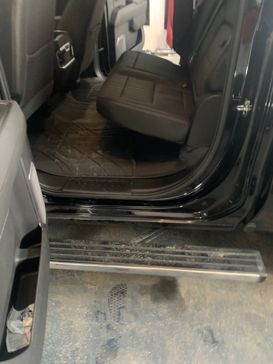

  1. Sorry for the late response. I changed phones and for some reason it wasn’t notifying that people responded to the thread. It’s sounds great. I may add the Kicker keyloc DSP line out to help clean it up. It won’t blow your mind but adds that bit more. I used a multi-tool to cut the bin to fit to size. It worked great and I used a new blade to get a clean cut.
  2. I added a JL 8” Amplified Microsub+ into my new 2022.5 High Country. Hope this thread helps. Utilized the following instructions from Kicker. Kicker Install Instructions I soldered my connections to the front driver door yellow and yellow black for my high level inputs at the spot the install instructions suggested. I utilized the RBC-1 Controller and ran it under the carpet and up into the console. Had to drill a couple holes. See pics. Cut the underseat storage tray with a multi tool. The JL is an awesome little sub. It sounds way better now and gives it good kick. I am going to add a Kicker Keyloc later, feels like it will clean up the sound a bit as I had the sub in a F-150 B&O with a LC2i and it sounded cleaner. I ran a power wire for it so I can add it later. Also going to replace dash speakers with the Audiofrog GS25 units as the next mod. Has anyone done this, looking for feedback?
