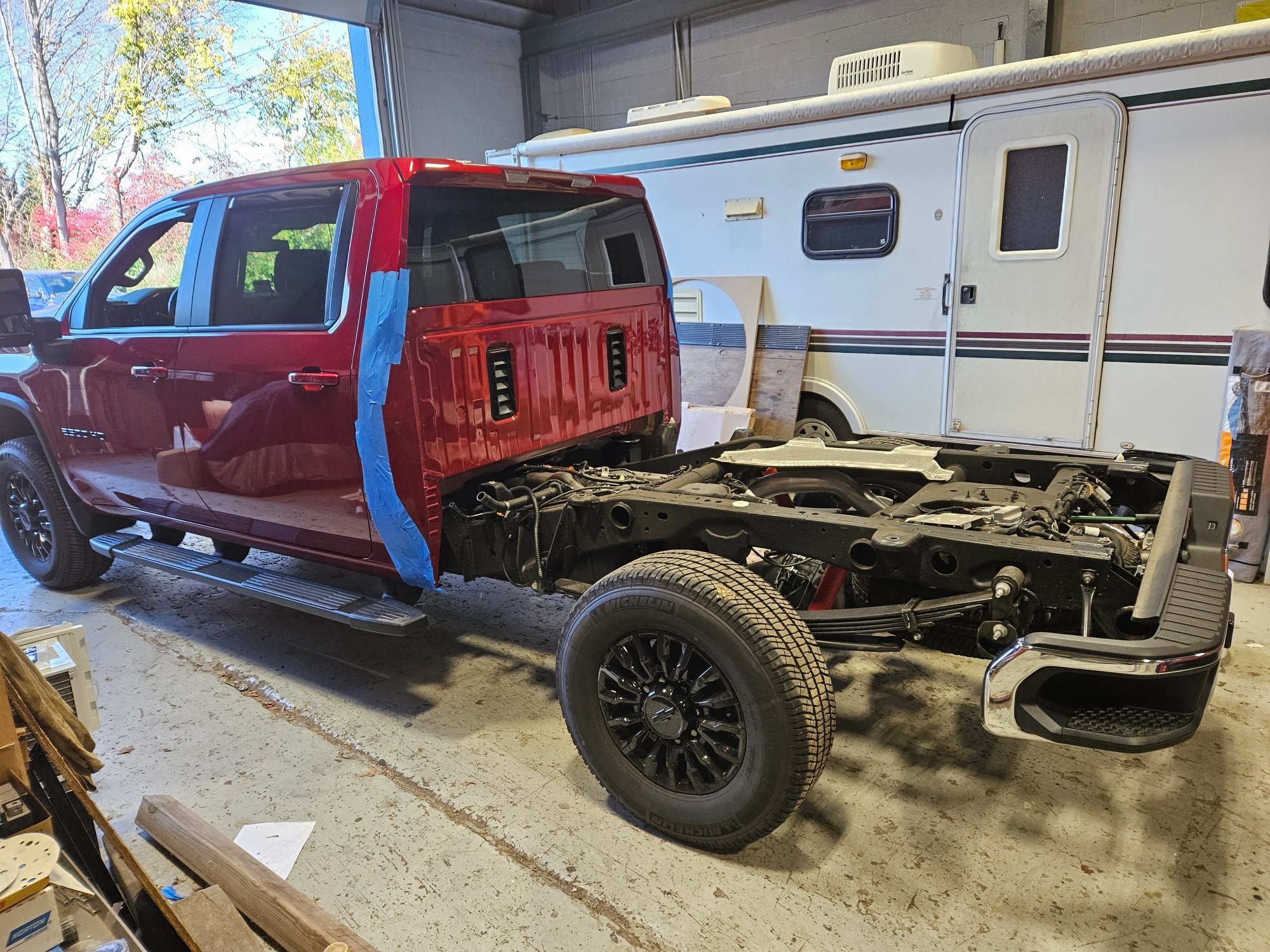

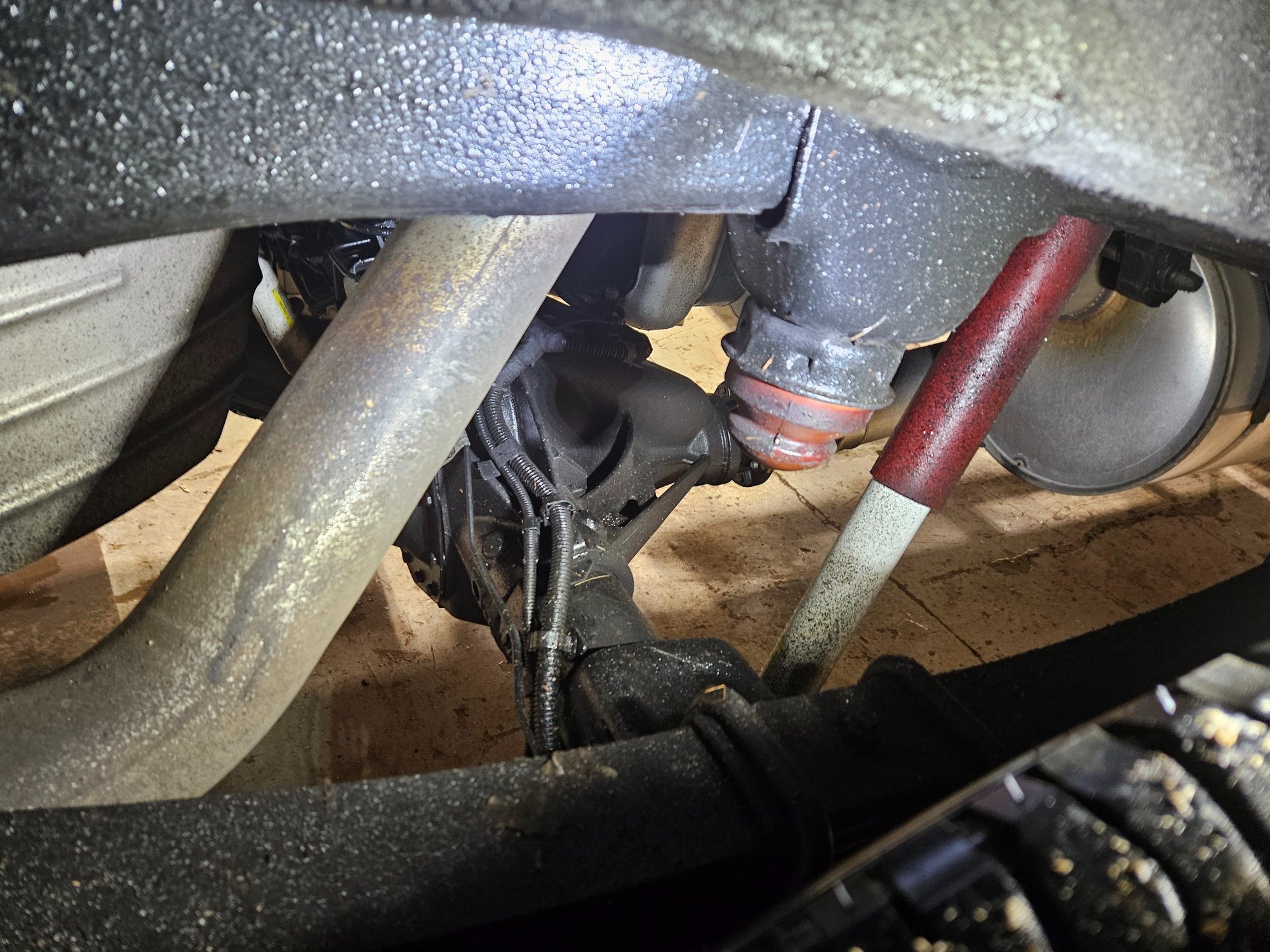

  5. Last week i brought my camper (35' TT @ 8000lbs) home for repairs. 24 2500 gas ccsb. truck only sagged 2" with the trailer hooked up. At 65mph the rear end was pretty squishy and had some sway. So i ordered a set of timbrens. Easy install, took longer to put the truck on the lift than install the timbrens. With no load i can barely squeak a 2x4 between the timbren and the axle. We will see next week how it changes the handling with the camper. Here is a before and after

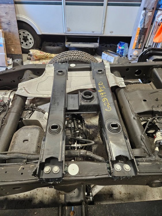

  7. If you look at the hitch there is a u channel in front of the ball mount. This is for clearance for a stiffener on the underside of the bed itself.
  8. Straight edge across the bed mount holes, measuring forward, and measuring multiple times. Hopefuly when i get the bed back on tomorrow its good. Should be fine as the factory covers are oversize to the hitch.
  9. Just had to nip back the heat shield where the two arms bolt up to the rh frame rail
  10. Making progress
  11. No. Had to back out of that one. Financing was stupid. Settled for an on the lot 2500 gasser

  13. 84632891 - hitch 11561075 - bolts x 8 84756188 - ball hole cover x 1 84756187 - puck hole cover x 4
  14. And if anyone is wondering the part numbers for the hardware are.... Bolts x8 pcs, #11561075 Ball hole cover. X1 pc. #84756188 Puck hole covers x4 pcs. #84756187
