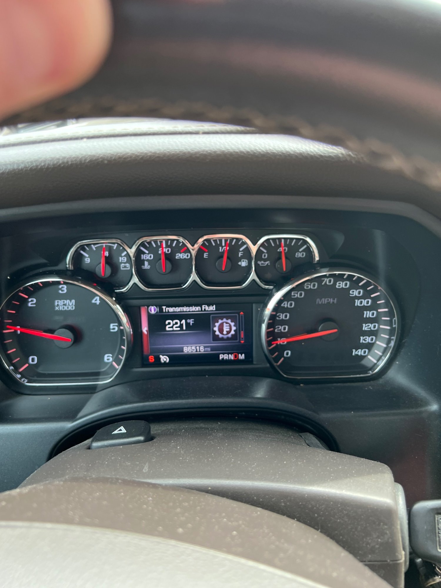

  7. These are the pics I made during my last long trip in March. 221° was when I came off the freeway to get gas. It rose pretty quickly to that temp. The 214° was a few days later at 70 mph after about 90 minutes of driving though Alabama….not too many hills.

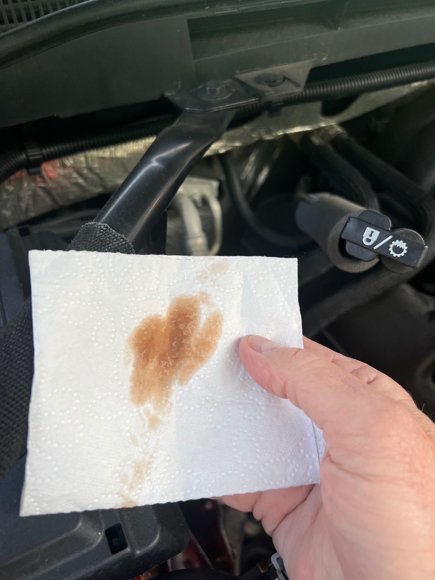

  8. I should also mention that the trans fluid has turned orange (see pic), and that’s with only 2,000 or so miles since the trans rebuild. It was nice and red after the rebuild. This discoloration seems to have occurred with my recent long drive in March with trans temps around 220°. Outside temperatures were less than 70° during the drive
