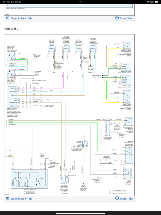

  10. My doors won’t automatically lock when shifted out of park. They will unlock when shifted into park though. I have a base model and there is no programming feature available. I looked at wiring diagrams but can’t see where the bcm gets its signal to lock from the gear selector or p/n switch. Does anyone have any ideas on how to diagnose?
  11. I found one and they don’t seem to share a common ground but I could not be understanding the diagram
  12. Thanks. I’ll search for one online. I don’t have a service manual for it.
