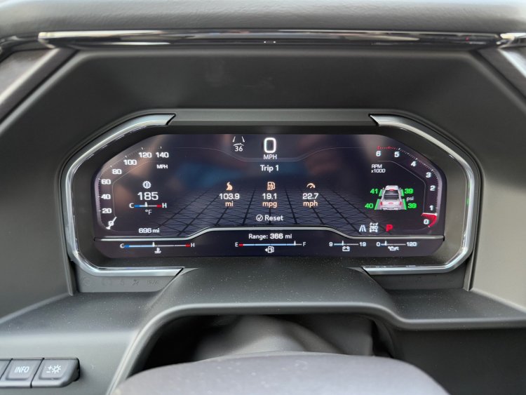

  9. That's so annoying, I just want a gauge to read accurately. Is something like the Banks idash the only good option to solve for this in a way that doesn't require looking at your phone?
  10. I'm baffled why it doesn't just use a percentile over time, in essence debouncing erratic polls. So 95th percentile over the last 10 minutes or something. Clearly the "miles remaining" is updating like this, I'm just at a loss for why the fuel gauge isn't, since the data is obviously there. It sounds like this is a "known issue" and not unexpected, then?
  11. Trip 1 is since I filled the tank. Readout is from OBD2.
  12. I’ve been doing pump calculated mileage over the last 600 miles and average a little over 20mpg. Lots of around town driving. I’m just surprised the fuel % might be 80% via OBD2 but the fuel gauge itself will show nearly full. I’ll give it a few more tanks, it wasn’t like this before, that’s why I was confused. At my current mpg I should get about 480 miles if I depleted the tank entirely, which I expect there is a reserve on. The estimated mileage is pretty close to what I’d expect.
  13. I’ve noticed after driving 70+ miles it has slightly moved downwards(perhaps a mm at most), so it definitely is moving, but there’s no way it’s even close to an accurate representation of remaining fuel. I’m showing 410 miles remaining, which started at 480, so the miles remaining appears to be working as expected.
