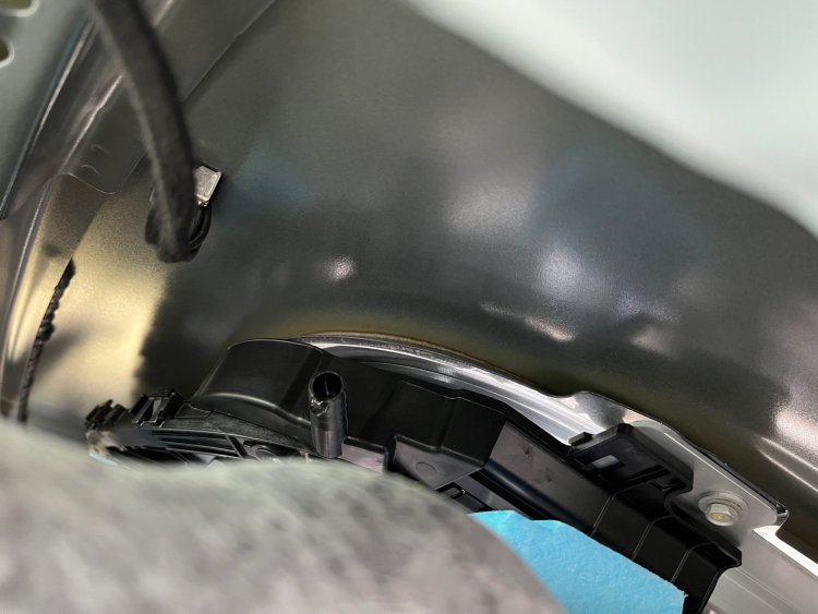

  3. @Unhappy client check your sunroof drains are actually installed, my 2020 seems to have never had the driver side drain installed at all, when I bought my truck I only had noticed the rear window leak and after some searching decided to do the fix myself to avoid damage to the headliner. also read that the fix from the dealer was temporary for many that ended up with leaks again… my fix is rounding 18 months.

  7. I have owned my 20' Sierra SLT for 2 yrs and have always noticed some small amounts of water on my driver side rubber mat, I initially thought it was from windy rain making its way through the door seal, but we have had some heavy rains this year that I noticed the water stain on headliner above the driver A-pillar, and noticed the water dripping down behind the dash, near the obd2 port...originally thought the source could be the shark fin antenna, so I partially lowered the headliner and ran a hose over the truck, only to realize the source is the sunroof drain...HAS NO DRAIN TUBE ATTACHED, looked to see if it had disconnected but it is not installed at all, anyone else have this happen?
