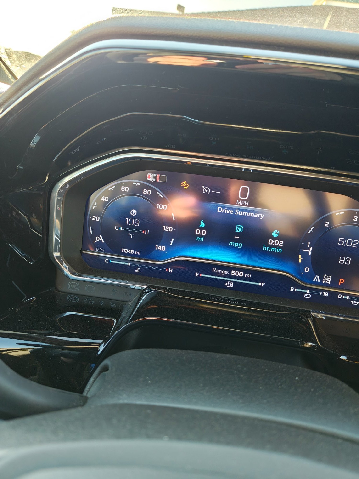

  2. First of all sorry, I know there are a ton of transmission temperature threads... My truck is a 2025 LZ0 High (10l89 10-speed) High Country with NHT max trailering package. The NHT package is supposed to have "enhanced cooling." Normally the trans temp sits around 200. It seems like with any real stress it quickly jumps into the 220s (for example climbing a grade unloaded at lower speeds). I haven't towed much with this truck, but I'm concerned if it gets this hot unloaded. I've tried a few different things to keep the temps down (tow/haul mode, sport mode, low range when that makes sense) and nothing seems to affect it. I'm curious if others are the same behavior or if anyone has found techniques to keep the temps down. It seems like it just can't handle reduced airflow at lower speeds, even with relatively light loading. Thanks!

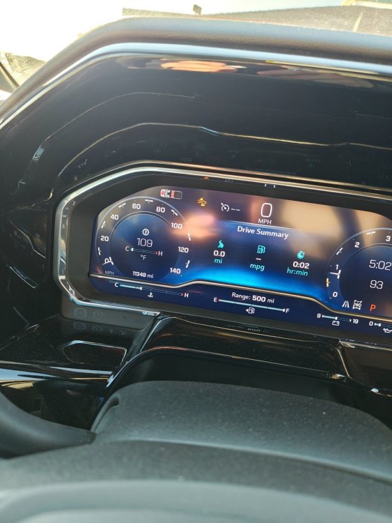

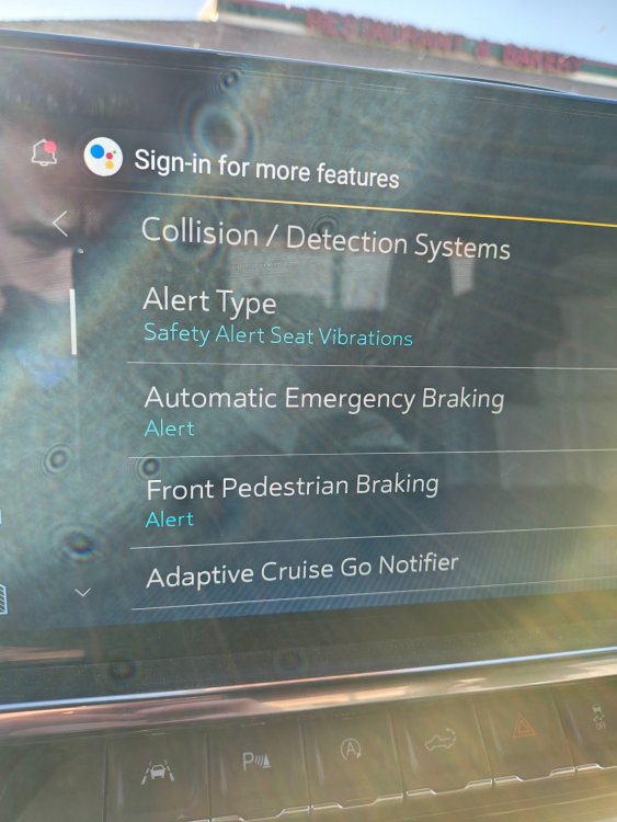

  4. This is meant to be informational and hopefully a time saver for some. I had a 2022 Silverado 1500 and currently own a 2025. In both of those vehicles I have always set "Automatic Emergency Braking" and "Front Pedestrian Braking" to "Alert" (instead of "Alert and Brake" or "Off"). These settings never caused the forward collision warning light to illuminate, until some point in the last couple months (possibly due to a software update?). Now having braking turned off on either of these settings causes the light to be illuminated all the time. I wasted a lot of time trying to figure out why the light was constantly illuminated, not knowing the display logic had changed. The only way to clear the amber light is to have both forward collision modes set to "Alert and Brake." I assume this was done out of some liability concern, but it is frustrating that selecting a normal operating mode (Alert) causes the fault indicator to be illuminated all the time, preventing the system from indicating whether an actual fault is present. I hope this helps anyone looking into the same issue.

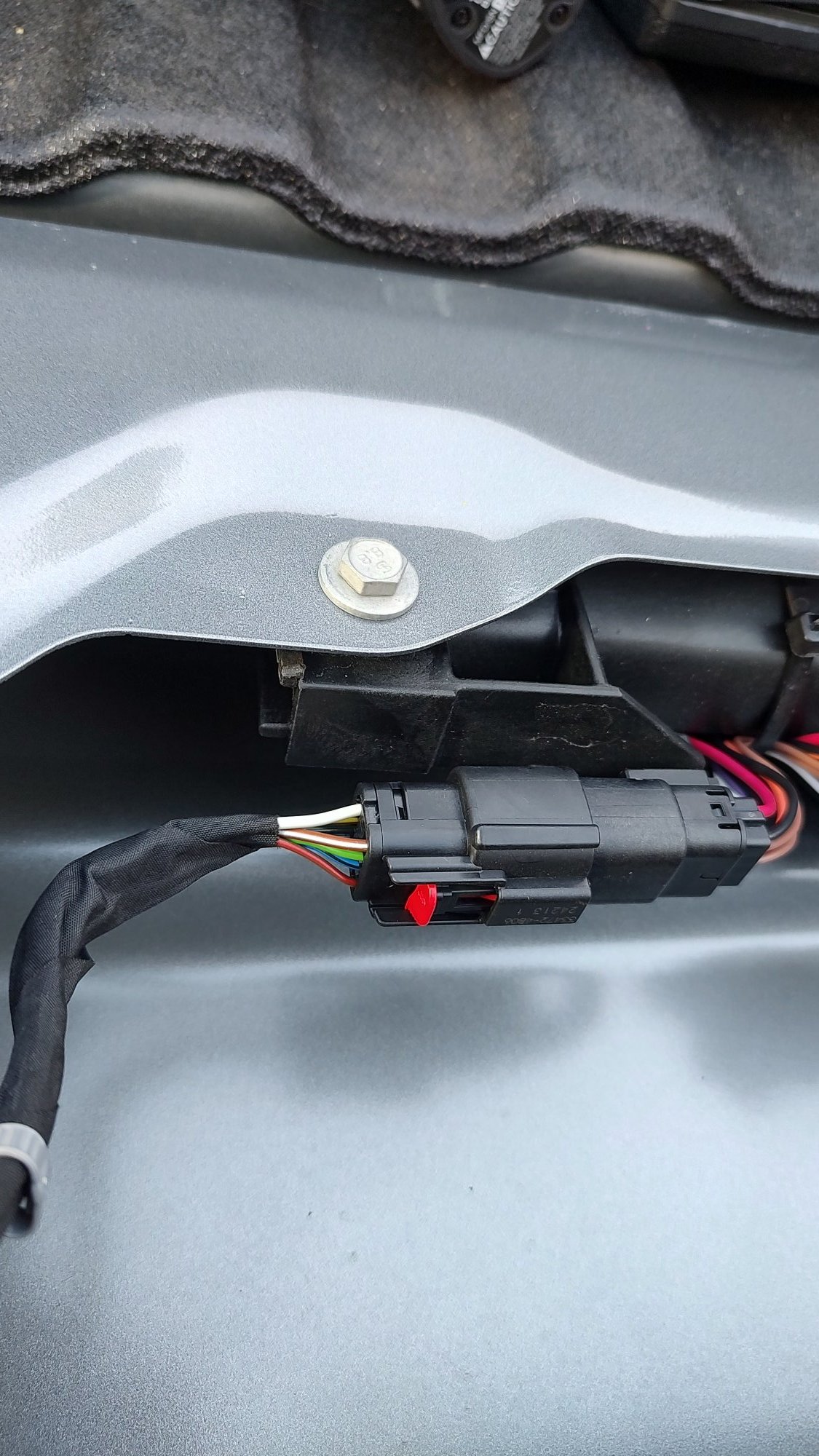

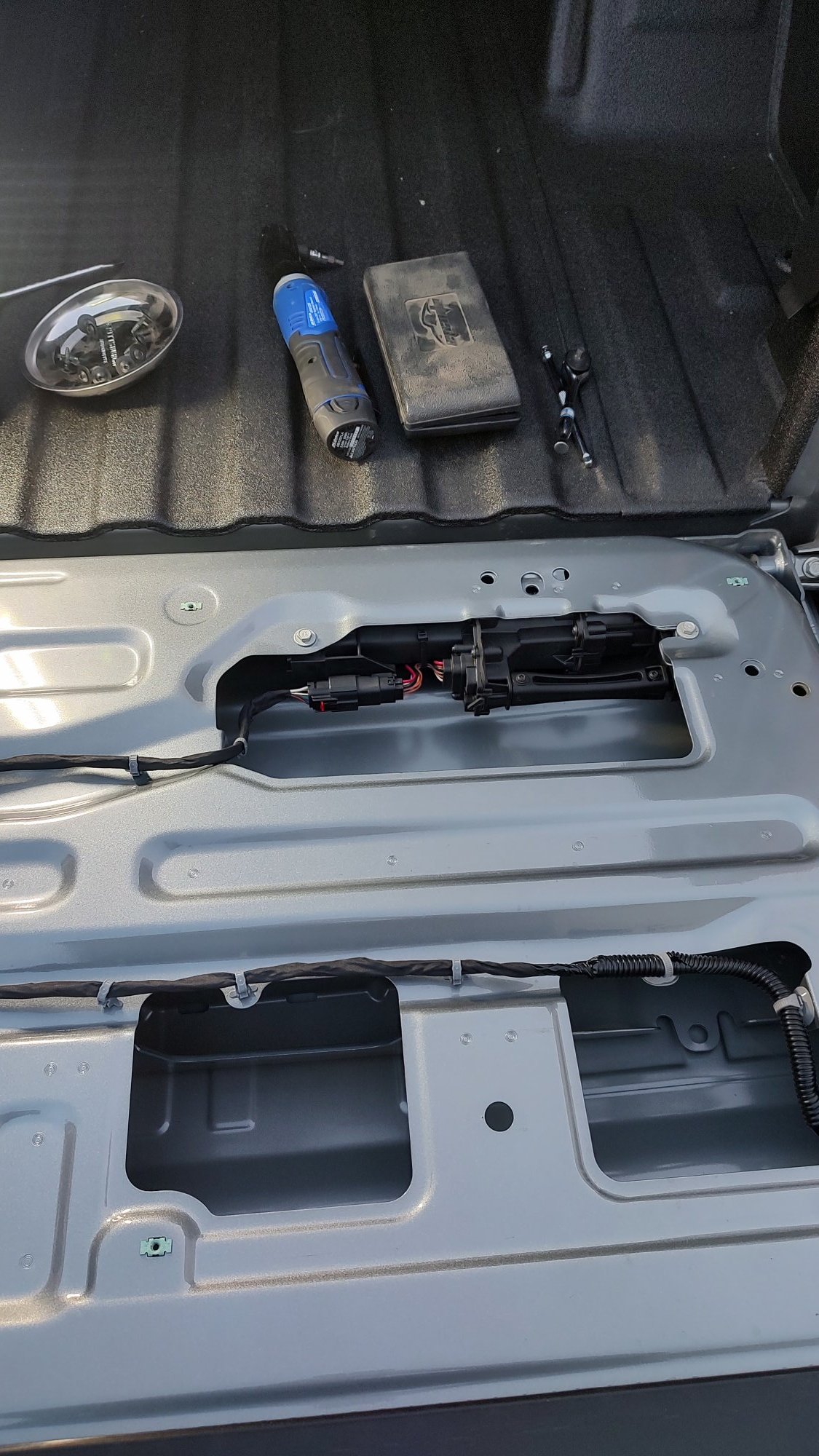

  6. 2025 Silverado 1500 High Country with power tailgate (non multi flex). Looking for a way to delete the power raise/lower feature and have the tailgate operate in the same way it would on a lower trim model without the power actuator. It seems like it should be possible because in some situations you can raise and lower it without the actuator assist and it feels just like the normal manual tailgate. I don't really have a use for this feature, and what I'm trying to be able to do is open the tailgate just a few inches to access the tonneau cover latch in situations where the tailgate can't open all the way (backed in against a fence, bike hitch rack installed). You can press the tailgate button a second time to stop the motion, but sometimes the actuator will resume if you subsequently lower the tailgate a little bit. It's already gone rogue on me once and gotten a pretty good scratch against a bike pedal. The only other way I've found to stop it is to block its motion, but that can't be good for the actuator in the long term. Does anyone know any kind of button-pushing cheat code to disable it? I tried unplugging the harness from the actuator, but somehow the actuator is tied into the logic for the latch. Having the actuator unplugged prevents the tailgate from unlatching and opening. Unless there's an easier way, it shouldn't be too hard to install a switch that would interrupt power to actuator motor, essentially allowing you to toggle the feature on and off. Does anyone know where to find a wiring diagram for the tailgate harnesses? Any ideas are appreciated. Thanks for the help.
