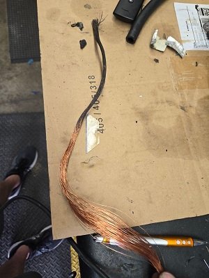

  1. I took your advice and so far it has paid off. Upon swapping my negative battery cable, I cut open the old one and found all types of corrosion. The worst of it was at the end of the thinner wire that grounds to the frame behind the passenger side front wheel.
