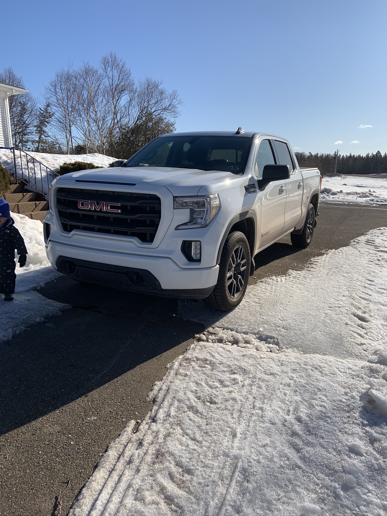

  2. Nice looking Truck. I like the white wheel well trim instead of black. What colour did you paint your rims? I have an elevation so mine are all black. I find they don't contrast well in certain light and look cheap.
