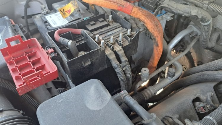

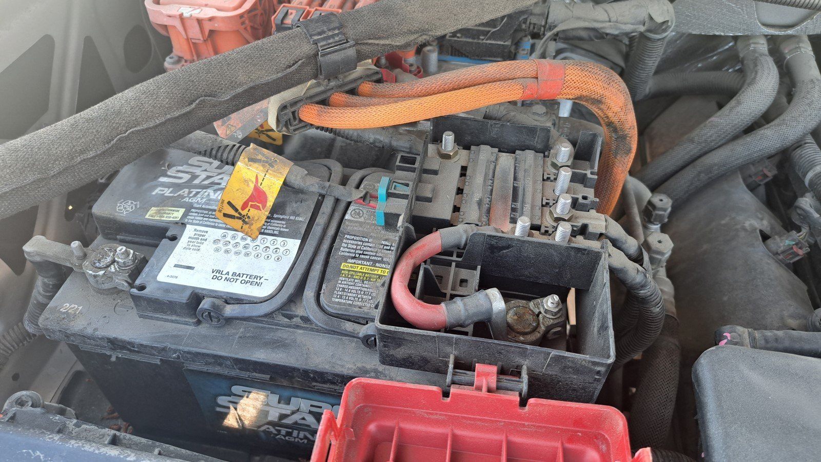

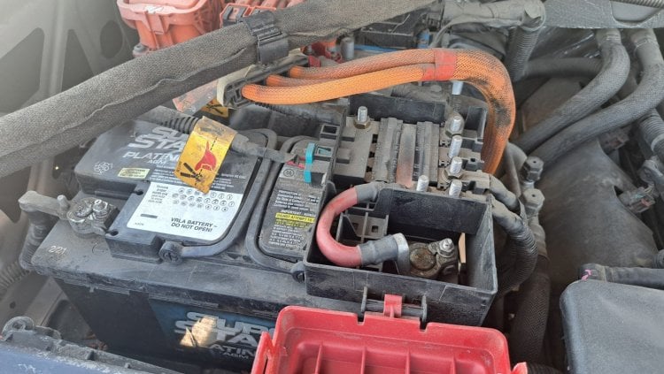

  3. Thanks for the link. That's the kind of info I've found but nothing with any detail of how it all works together. The 12v battery has one ground wire and the positive post has a terminal block with three large wires (fused). Fuses are good. One goes to the starter, one goes forward to power steering rack (I believe) and one goes to the inverter. So the inverter and 12v battery are connected. The BAS has three large wires coming out of it all covered in orange sheathing. I don't see any other wires connected to the BAS but I could be wrong. If the wires are what is stated above, the generating function of the BAS would send current to the HV battery/inverter, which would then send current to the 12v battery. I've reset everything I could find in the scanner as far as HV goes with no change. The voltage gauge on the dash also works and shows low voltage (around 10.5v and continues to go down). I've run out of logic and the rest is over my head.

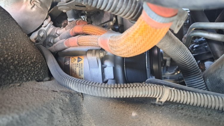

  4. We just got in an '18 Silverado from an insurance auction with the e-assist hybrid system and it's not charging the 12v battery. I've search and found others that had a similar issue but no one ever posted that they solved the problem. It was hit in the right front near the 12v battery and inverter but it was minor and didn't get into the area enough to damage any wires, etc. It starts with a jump and runs and drives but since the 12v battery isn't charging it eventually dies. Does anyone know how the e-assist system works as far as the alternator/motor, charging the HV battery and charging the 12v battery? There's no wires going from the alternator/motor (whatever you call that thing) directly to the 12v battery. It looks like there's three orange wires going back to the HV battery and that's it, so the 12v battery would have to be getting charged from the HV battery? Also, the only codes we got were low voltage related and I went through an reset any crash related processes I could find.
