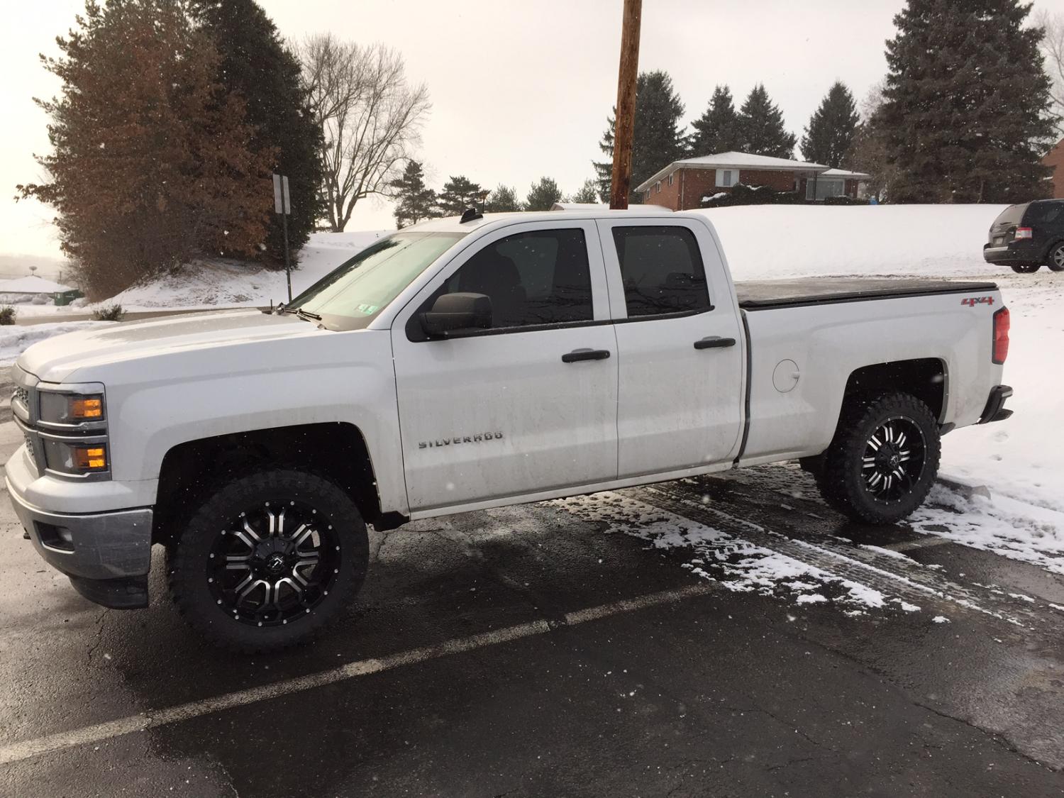

  1. They are Atturo M/T 33x12.50x20. Yes correct. RC 2" level.
  2. RC 2" Level. Atturo M/T 33x12.50X20 on TIS 535MB Wheels 20x9 18mm Offset. Loving it.
  3. For those of you with the 2'' Rough Country level on your 2014/15 truck you can run a 33x12.50x20 Mud Terrain tire on a 20x9 wheel. I did it today. No problems. No cutting or trimming. If you need pictures or more info let me know. I searched and searched and could not find a soul running what I wanted to run on my leveling kit. So you guys running just the level it will work!!!
