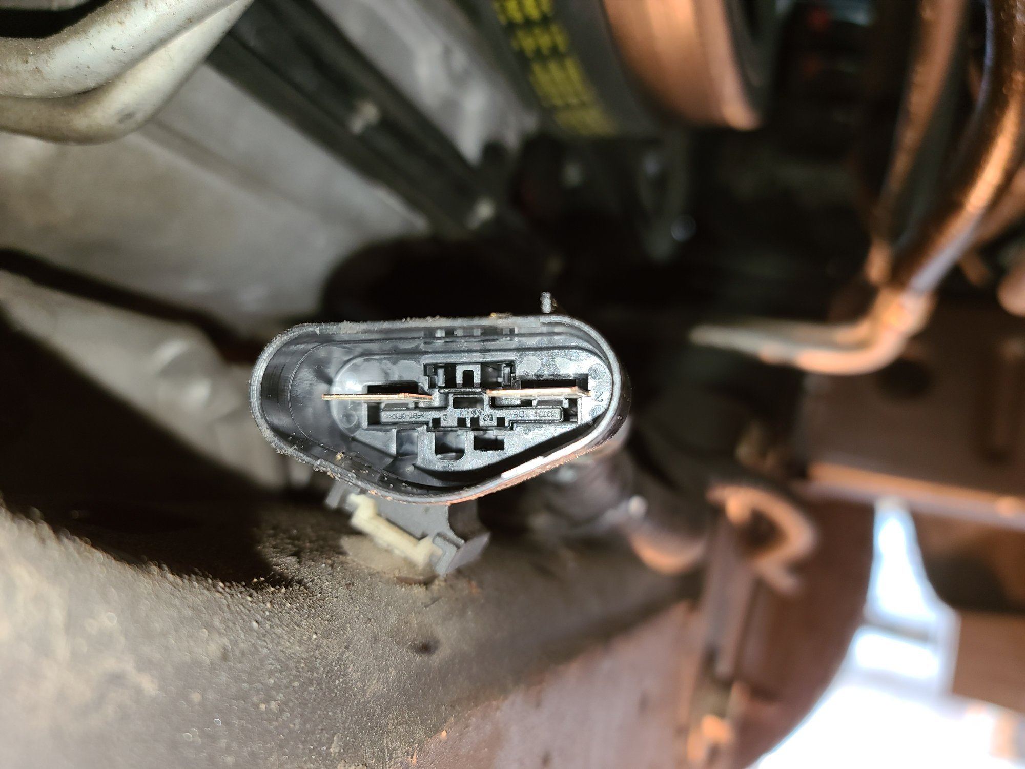

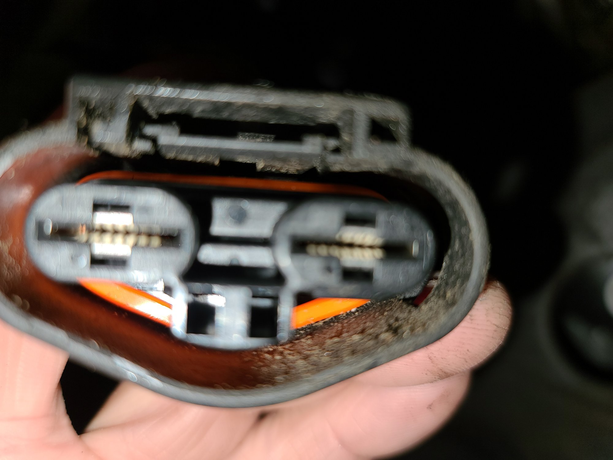

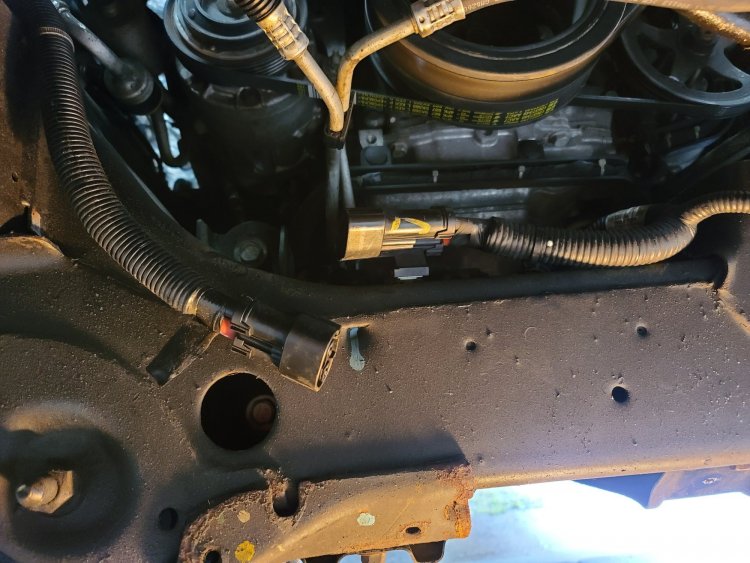

  1. Almost 4 weeks now since the 2 repairs I did, (pictured above and negative ground on frame) the truck is running very good so far. My problem was one or the other or both. I had all the same problems in previous posts. My buddies 05 Colorado has the same issue. Driving down the road and it just dies. Climb under the front end and smack the crossmember with a hammer and it runs again. Has to be that connection in the pics above.
  2. Has anyone with these electrical issues tried looking at this connection ? Drop your plastic skid plate thingy and it's right there. It comes right from the battery, (both negative and positive) and goes to the ECM. I just did mine today. It had a mild to heavy white frosting on both the blades. I took emery cloth and cleaned them, then applied dielectric grease. Have to wait and see what happens.
  3. Part # 84494554 $48.80 with tax My alternator gauge seems to be working normally now. We'll see what happens.
