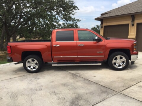

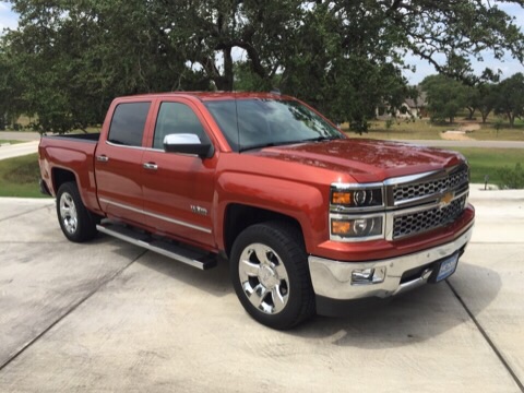

  4. Some pics of my new baby that I picked up Friday... Happy to be back in the Chevy truck family.
