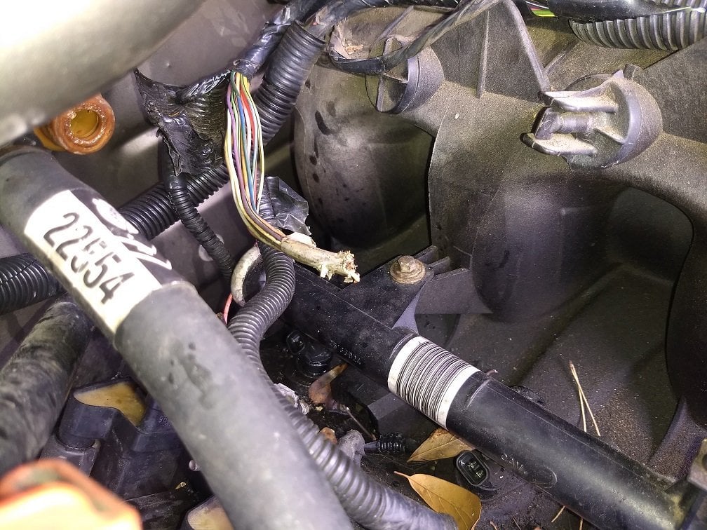

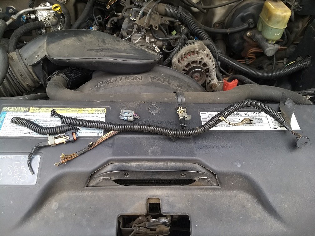

  1. I have a ignition wire harness that seems to have been chewed by squirrels (see photos). It seems to go all the way to the main fuse/control box but all the harnesses I can find seem to imply there is a connector somewhere along the way but I cannot find it. Can someone tell from the photos what I need to repair this? I thought about splicing it but there are connectors that are cut off right at the end. TIA.
