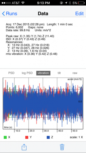

  1. The app is called Vibsensor, is on my iPhone and can be downloaded from the App Store ($5 for full version). It records all sorts of data for one minute at a time. The data I posted was taken at 70 mph on the same stretch of road before and after tires.
  2. Here is my before/after vibration test. Before was how the truck came from the dealer, after is with the new tires.
