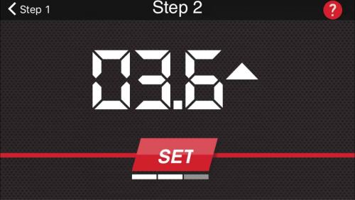

  1. 14 Silvy - Don't know if this helps but here is the angle measurement at my rear pinion.
  2. 14 Silvy - I will get my angle finder out and take a pic this weekend measuring the angle. I will post it up on Monday for you.
