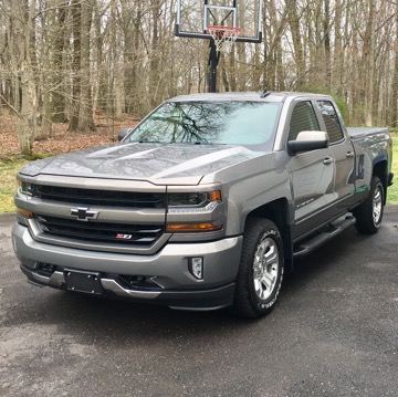

  1. Hey guys. FYI- I had toyo open country A/T's onMy GMC Sierra 1500 Z71 LT275/65R18 the dealer said they were bad. This was after the OEM tires were supposed to be bad. We took the Toyos off and put on LT275/65R18 BF Goodrich KO2 load range E and it was better but still there. They called the GM rep in and of course he blamed the new tires, saying they were aftermarket and not factory. I told them to swapp my tires with a stock unit and the vibration was so bad he could not believe it. The rep said the tires on the stock unit must be bad too. Hard to believe they say this crap with a straight face. We put my BF's back on and he says commercially acceptable. I filed for CT lemon law and won. I now have a 2017 Silverado and so far so good no issues at all. Smooth up to 85. I won't hold my breath....
