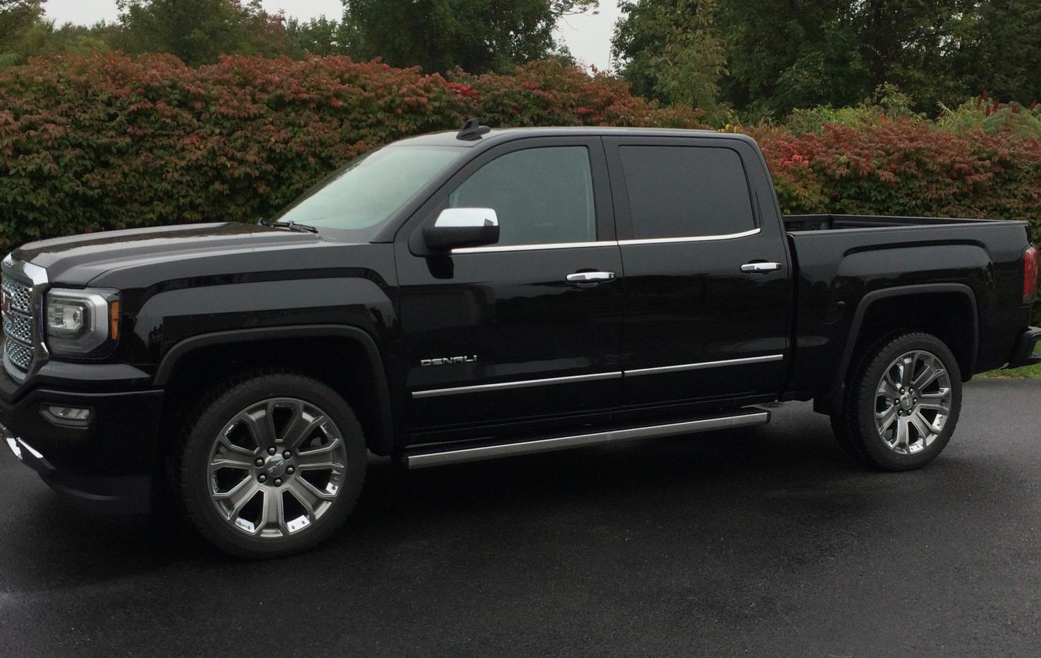

  9. Tiger_993, those rims look great on your truck!
  10. Wow! Those are gorgeous! Love your truck! I almost bought a black High Country...kinda wish I had.
  11. This is my truck now. I'd definitely love to see a pic with the chrome 6 spoke.
  12. I am thinking about getting a new set of rims for my 2017 Sierra 1500 Denali. My Sierra Denali has the Ultimate package with the 7 spoke 22" rims. While I like them, they just don't have the same appeal as some of the other GM wheels available. One set in particular is the 22" 6-spoke chrome rims (SEZ) 19301157. I also like the 22" 6-split spoke ultra bright machined manoogian rims (SF0) 19301161. Does anyone have these rims on their truck? I'd really like to see what they look like on a Sierra or Silverado.
