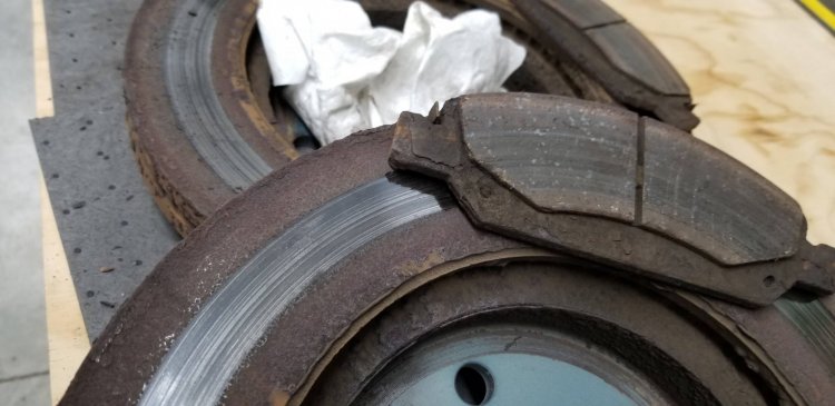

  4. The fronts on my '88 Firebird (with C4 HD swap) with Hawk pads started doing that ages ago and I never figured it out, figured some part of my assembly was off. Then my 2016 Sliverado started doing it occasionally and I never touched them! After doing the brakes on my truck it went away, so pads and rotors along with a little fresh disk brake lube were the only changes. My current theory is the pads... but only because I greased the snot out of the Firebird brakes with no luck and I really doubt it could be the rotors! Speaking of GM rotors, check out this wear pattern!
