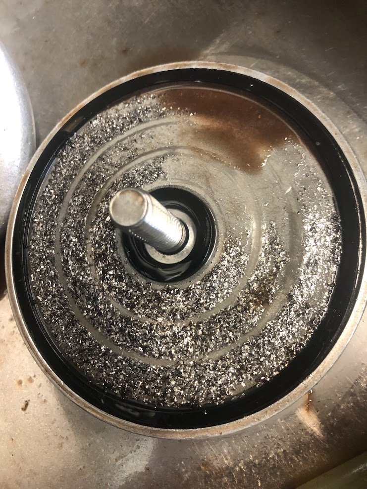

  5. My torque converter failed on my '11 Yukon 3 weeks ago and the symptoms were similar with RPM jumping, trouble finding and staying in gear and for the prior couple of mos., a noticeable hard clunk on downshift from 2nd to 1st when coming to a stop. Your stabilitrak error is a separate issue. If your TC is failing, you will need a rebuild. You have metal fragments throughout your entire system including the radiator and trans cooler/cooler lines that will need to be flushed with special equipment. It's not a simple diy and will require TCM coding if you swap in a different rebuilt unit. Find a reputable transmission shop to handle a rebuild and ensure they upgrade components to address known failure items. I paid $4300 for my rebuild.
  6. Yes, it was the torque converter. It's being rebuilt now and it's loaded with metal frag.

  8. I'm curious how many miles folks are getting out of their 6l80 transmissions. I've maintained my 2011 Yukon from new with 50k mile transmission fluid and filter changes and it just left me stranded 300 miles from home at 219k miles on the odometer. No warning signs until the day of the trip when it started clunking a bit then wouldn't shift at all when getting back on the highway. I managed to get it to shift into fourth gear for a 3 mile drive to a dealership lot off the highway where it sits, 5-1/2 hours from home.
