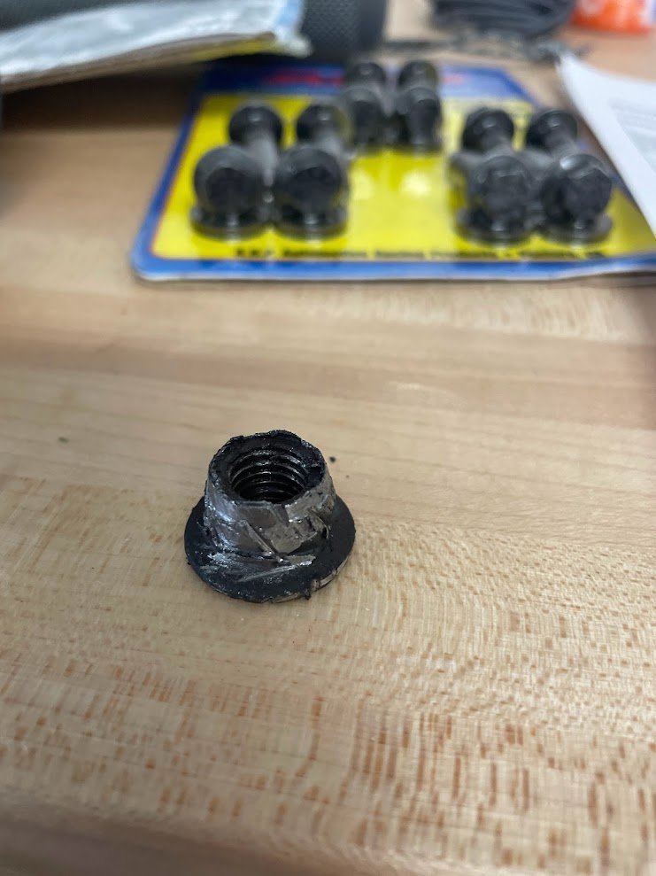

  21. New manifold bolts and a gasket did the trick. The exhaust flange nuts are relentless at being a PIA to get off. I got two off with MAP gas but the one with the worst access rounded and turned into a mess before finally getting some bite with a second bolt extraction kit. That alone burned two hours.
