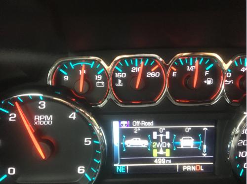

1,215 profile views

  1. So took my truck in for service and I was told that it is normal. I guess the new 2017 Silverado's have Active aero shutters in the front to improve MPG. So when I give it gas the shutters close to minimize drag.... Not sure if I like this answer but I think im going to hook up my go pro under the hood to see it in action.
