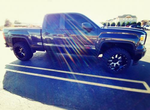

  8. That's where I got all of my information from and it said the same thing, minor trimming that's why I went with the set up. I'm hitting front and rear even after metal trim. Sent from my LG-H918 using Tapatalk
  9. I would say you will have to do a body lift. I run a 20x12 -44 offset with 2 inch level and 33x12.5 tire and even with major cutting I still rub. I will eventually do a 3" lift on the truck that should solve my problem. Sent from my LG-H918 using Tapatalk
  10. I agree, I went with black wheels with machine blades and it looks great on a dark color truck! Sent from my LG-H918 using Tapatalk
  11. I put a RC 2" level but still had to do quite a bit of trimming to get it to not rub. Sent from my LG-H918 using Tapatalk
  12. Just put these on about a week ago. 20x12 with 33x12.5 Federals. Sent from my LG-H918 using Tapatalk
