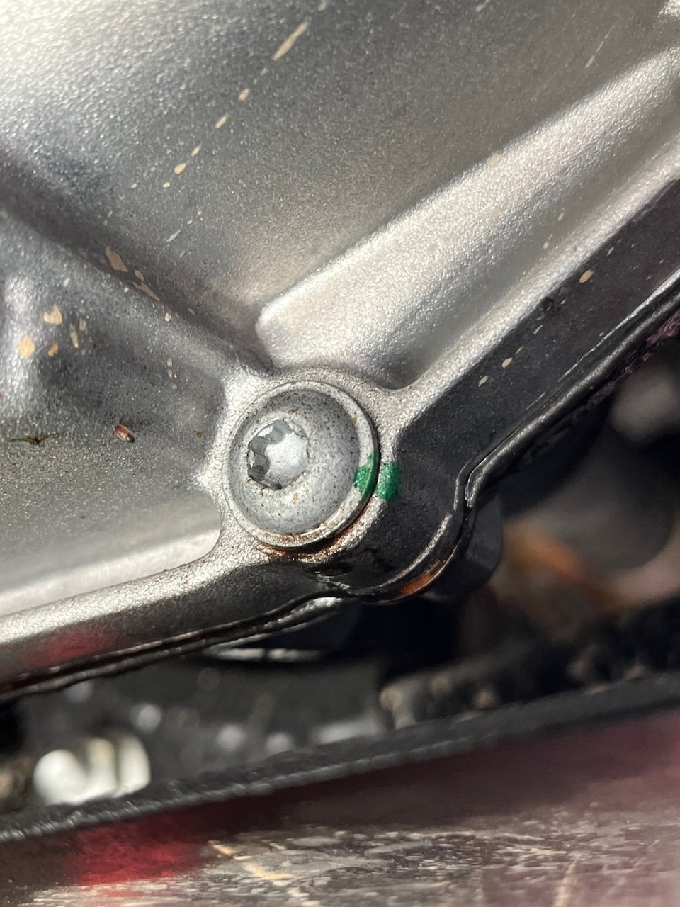

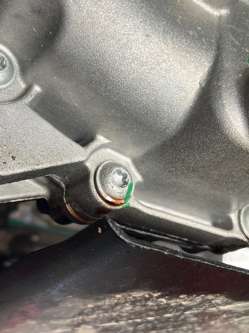

  14. Had my truck (24’ Silverado 2500HD gas CCSB) on the lift changing out the rear diff fluid. Found my transfer case is leaking. Nothing major, but don’t like a few month old truck leaking fluids. Truck has 7200 miles on it. P.S. I was changing the rear diff fluid because it was about a quart low when I checked during the 1000 mile initial service. I added a quart of 75w-90 mystik synthetic to top it off. Didn’t want mixed fluid in the rear end long term.
