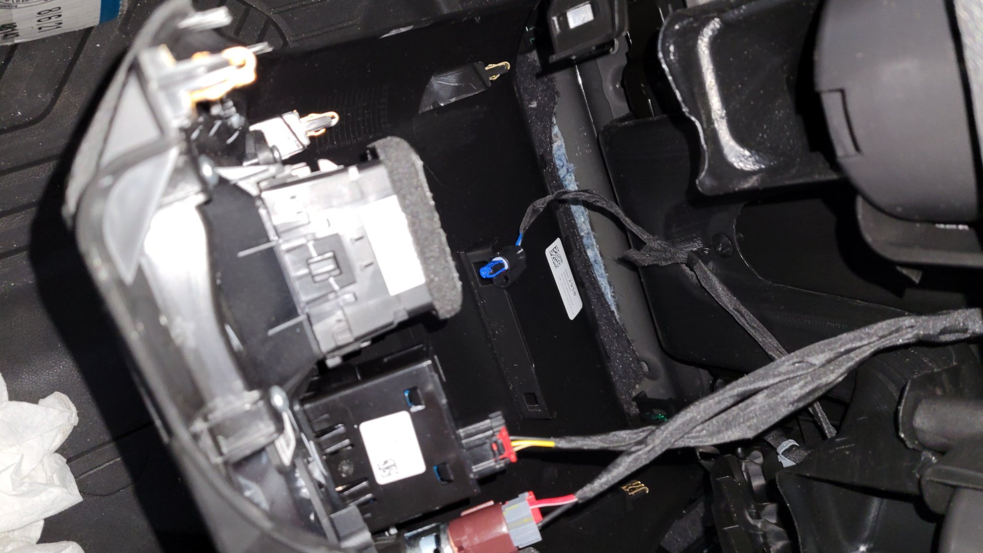

  1. So there is a second module that goes in the back of the console.. not just the one under the cup holder. When I swapped my jump seat for a full console, I had the same issue with the remote start and door button locks. Once I installed the second module in the rear of the console it worked great. Not sure about the wireless charger. Mine worked fine after the install of the console. Hope this helps

  5. Ricky I had to purchase a remote start module for my new console. Once I installed it, I was able to use my remote starter, my door press locks and the message disappeared. The dealership had ni idea what to do, but I found the module on a gm part website... hope this helps Don
  6. Hello, I recently installed a center console in my 2020 HD. I took out a jump seat. It was new, but didn't come with the Anti theft module that goes under the cup holders. I purchased one and installed it. But apparently there is a second module in the back of the console that controls remote starter on the key fob. Does anyone know the part I'm speaking of. I can't find it anywhere on GM part sites. And the dealership can't find the one with the right connector. Any help would be greatly appreciated... thanks Don Here is a picture of the blue connector
