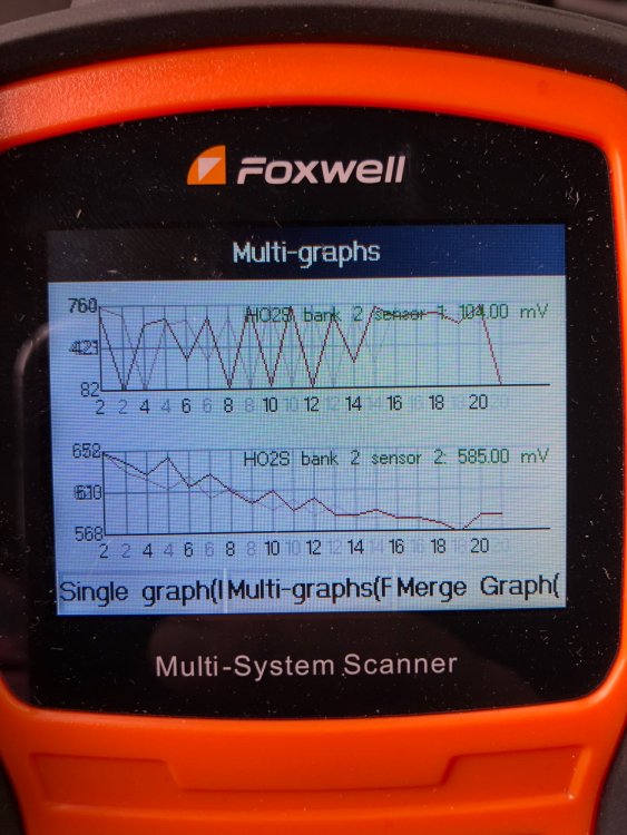

  6. Here is video starts at idle then about half way I rev to 2k and hold at 2k and here is only idling both are after a drive so everything is up to temp
  7. Any Thoughts/feedback on O2 readings? I can get more data if that would help
  8. Ok took these today…this is after 20 min drive so everything is up to temp.

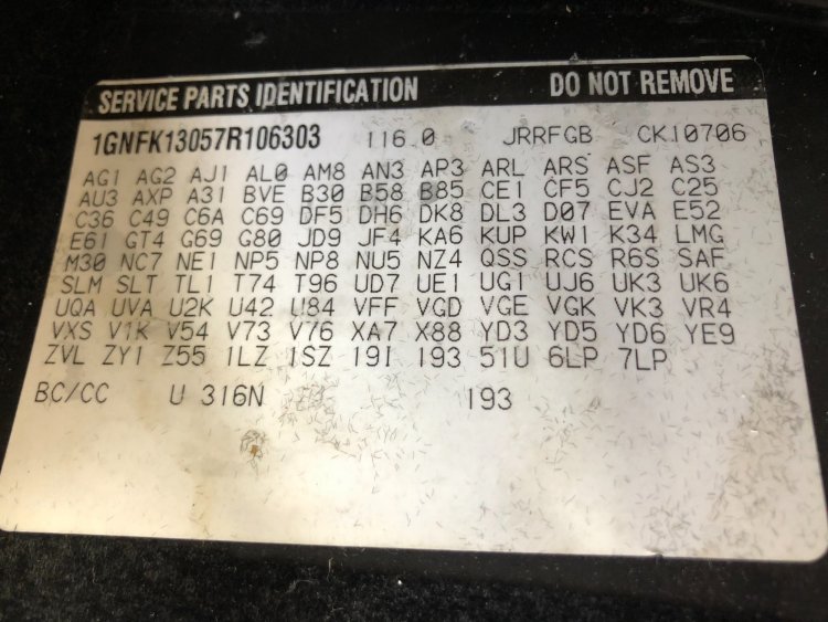

  11. Sure, I took this when i was confirming which tccm I needed when the 4wd went out
