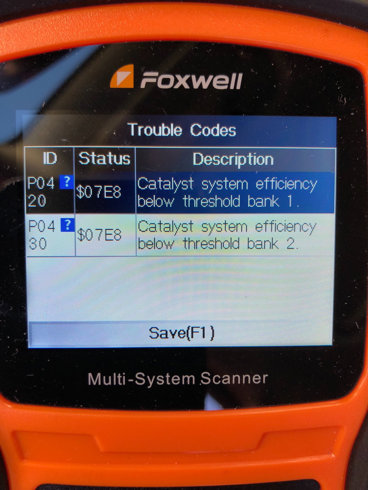

  2. So today I took a drive and my early Christmas present…engine light off on its own!!!!! I guess the anti foulers worked and I don’t even have to feel too bad about the actual environmental impact because it has 2 brand new cats doing their thing, just not CARB cats…what a journey
  3. I spaced the sensors out with modified non foulers…how long should it take for the CEL to go out if this is effective?
  4. so I can expect an efficiency code until procuring and Installing a CARB cat?
  5. How would I determine this if in open loop? Regarding exhaust, yes it’s brand new manifolds, gaskets and cats/ y pipe…I replaced them all thinking my cat efficiency code was due to exhaust leak.

  14. Hi all, I have a 2007 5.3 throwing codes for Catalyst efficiency bank 1 and 2. I have been chasing this like crazy and am at whits end…hoping an expert can help. In my efforts to resolve I’ve just done in the past 8 weeks… New fuel sending unit (old one rotted) 8 new plugs (AC Delco 41-162) 8 new plug wires new driver side valve cover (updated style) and pcv hose (to ensure no leaks) new exhaust manifolds and gaskets both sides 2 new cats/ y pipe (Davico $550) 4 new oxygen sensors new coolant temp sensor new crank position sensor cleaned MAF cleaned throttle body as you can probably imagine I’m beyond frustrated at this point. What else would cause the catalyst efficiency codes? When I clear them they return.
