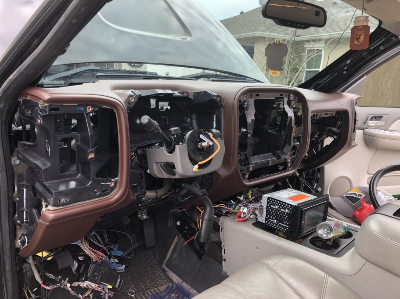

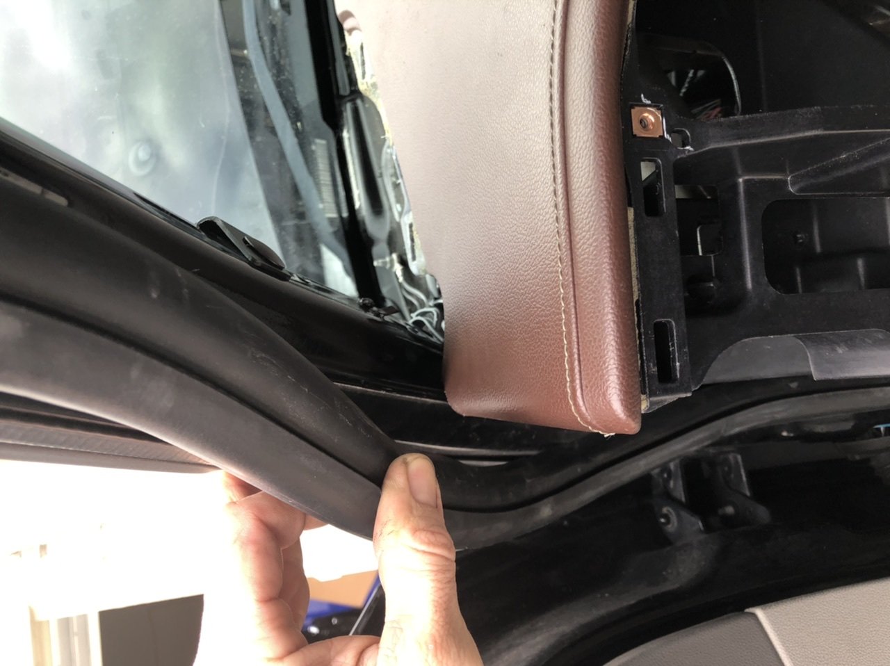

  3. Thing holding me up on the dash is the airbag. Need to make sure it works

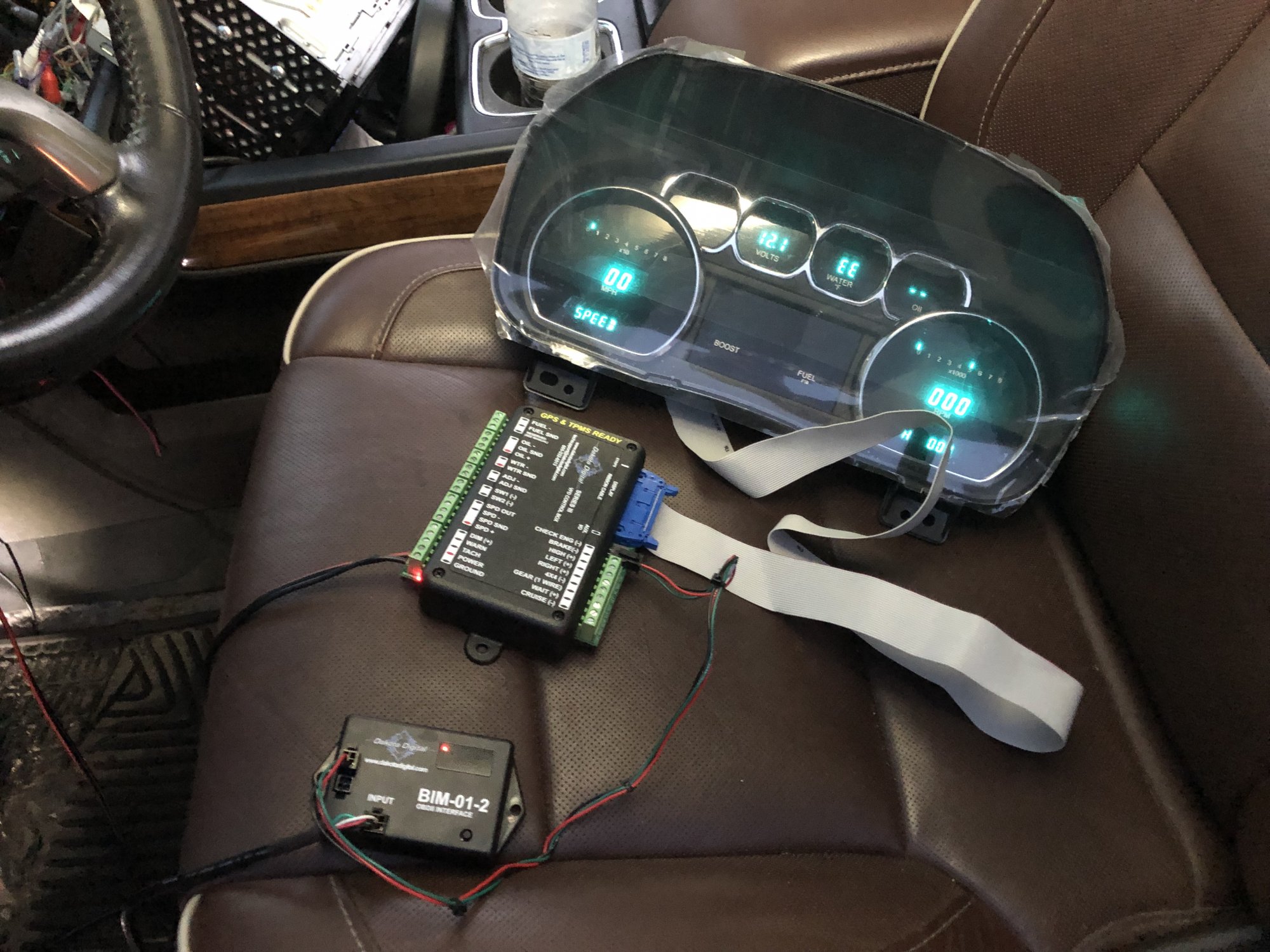

  4. If you do the dash you’ll either need to swap all the computers so you can use the electronics or get with Dakota digital and have them put gauges in the cluster. I wish I went with needles but I still like this look. The center has boost and fuel psi
  5. Got the seats and center console in but haven’t had a chance to install the dash

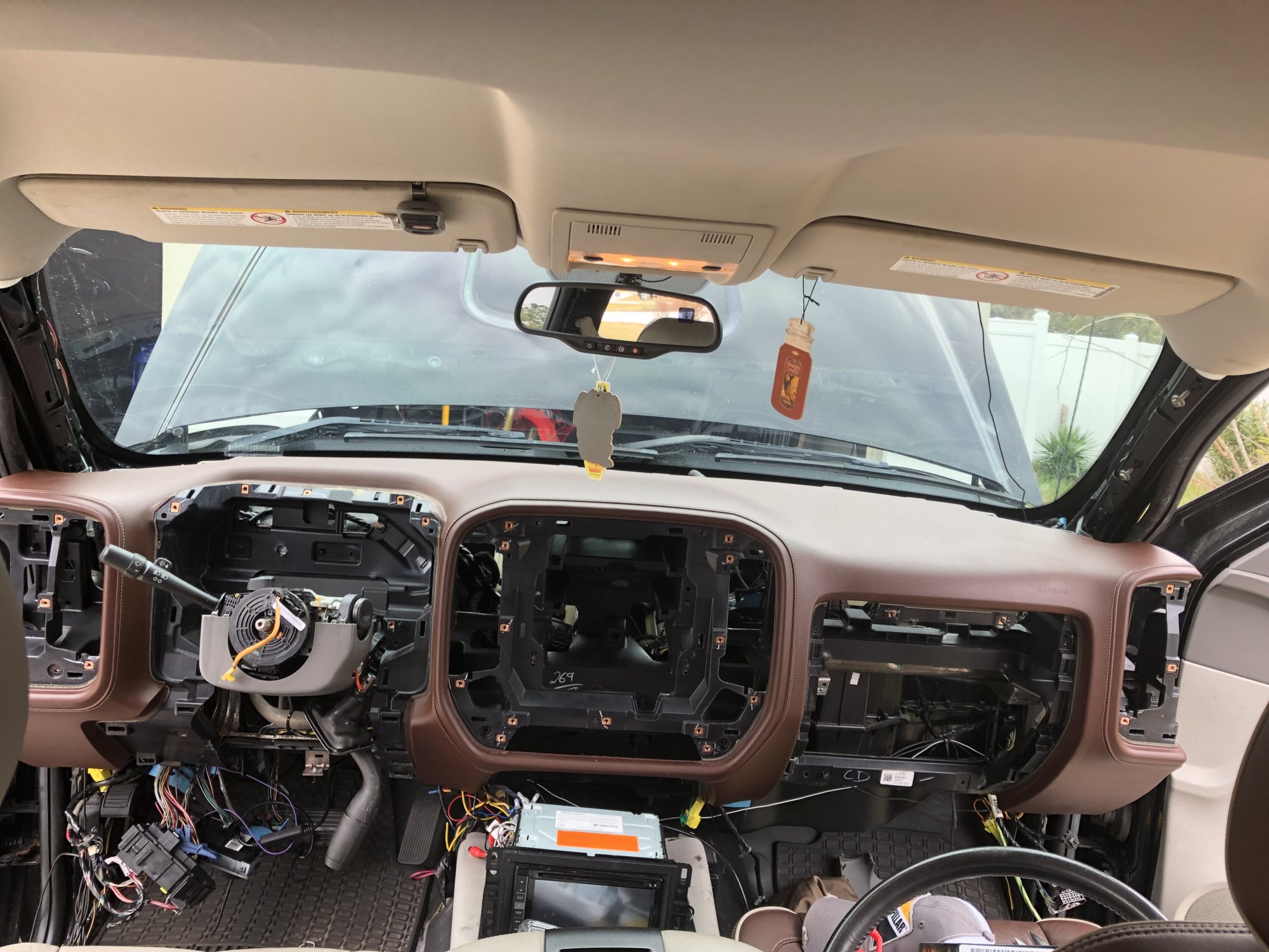

  6. Should be test fitting the dash this week. I’ll update when I can

  10. Hello everyone, I figured I would make a thread to showing my interior swap. I’m going from a 2008 gmc 2500 to a 2017 Chevy high country interior. So far I’ve swapped over the back seat and carpet. Back seat bolts directly in.
