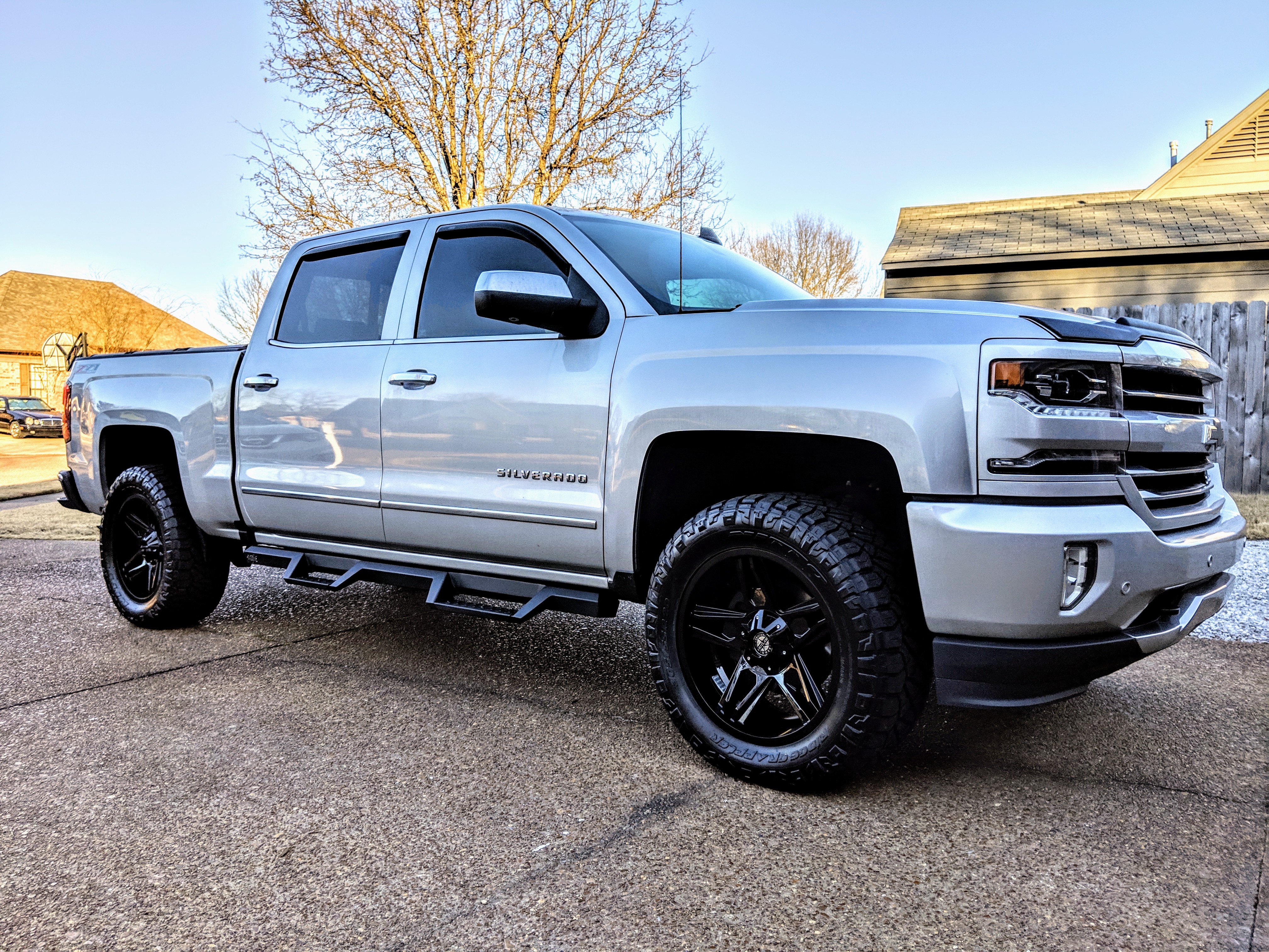

  1. Grille and headlights are stock. '16 Z71 LTZ. tires are Nitto Ridge Grapplers 305/55/20 on 20" american outlaw wheels. 2" front level kit.
  2. Thanks. The steps actually line up perfect and i use them. I had the factory chrome running boards on before. A bit of a PIA to install the center brackets due to sh*tty instructions. Worth it though, as I think the look is sportier then the running boards.
  3. Rough Country 2 inch front level block, American Outlaw 20 inch wheels, 305/55/20 Nitto Ridge Grapplers, Westin HDX step down bars.
