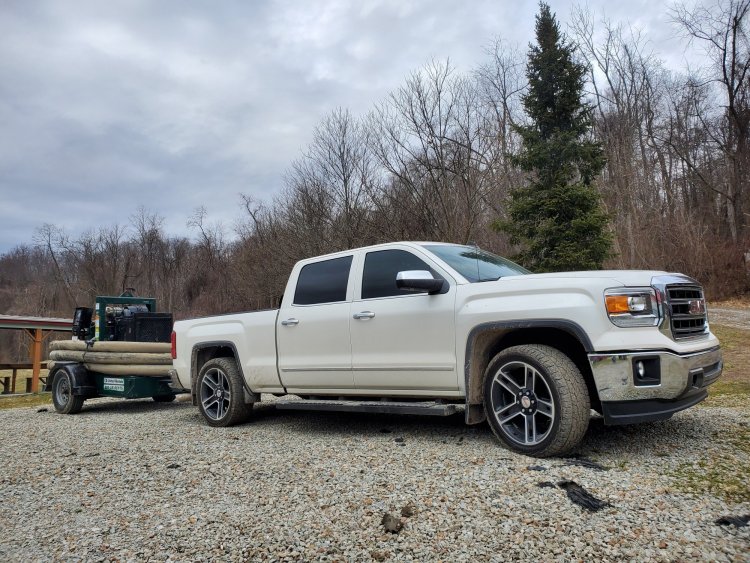

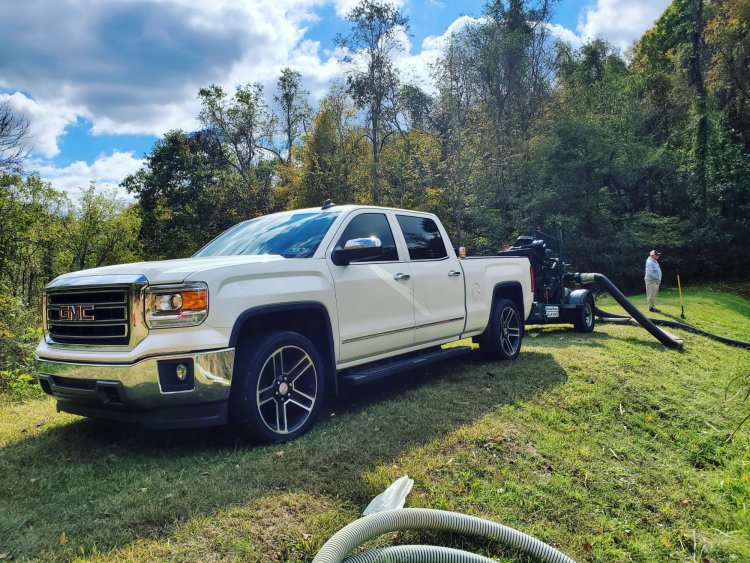

  7. Well, long over due update... We had a very mild winter with nearly no snow. Only once I found myself driving through a few inches of fresh snow. First tracks at 4:30am, completely untreated roads. The tires did fantastic. Up and down steep hills, I tried 2wd and 4wd. Light and heavy throttle just to find the limits, etc. Over all, I'm very impressed. They do very well, and are a perfect balance for a daily driver in all conditions. They seem to be wearing well (despite the dealer not rotating them on the last service I'm gonna rotate them this week during the virus lockdown). They don't do as well as dedicated snow tire, as expected, but they are the best compromise I could have found, based on my current experience for wear, noise, wet weather, snow and offroad. I did end up finding the mud/slick limit of the tires on another job site while backing a 6800lb pump/trailer up a steep/short incline. I needed a tug from a tractor to get it all up, but not at all surprised nor unexpected. Still loving these tires and definitely highly recommended. I am still of the belief that these may be the best kept secret in the 285/45/22 A/T truck tire market.

  10. I know it's no where close to the weight capacity, but I never what I will be towing/hauling around or how far it will go

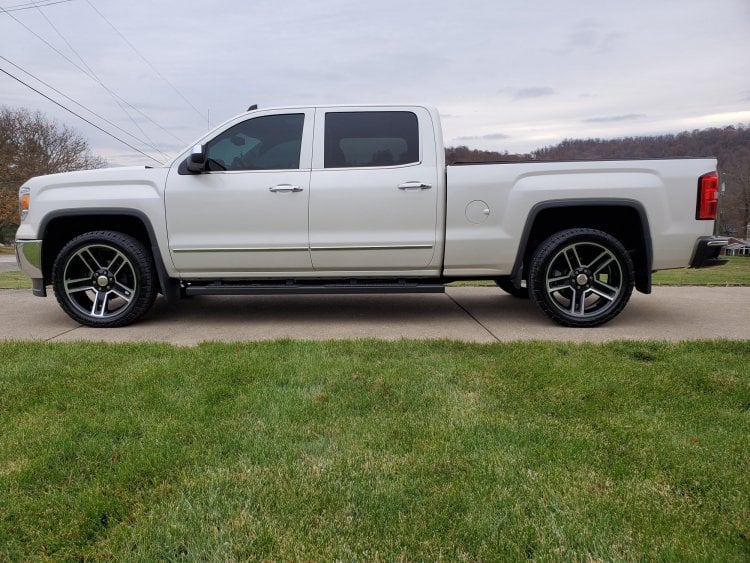

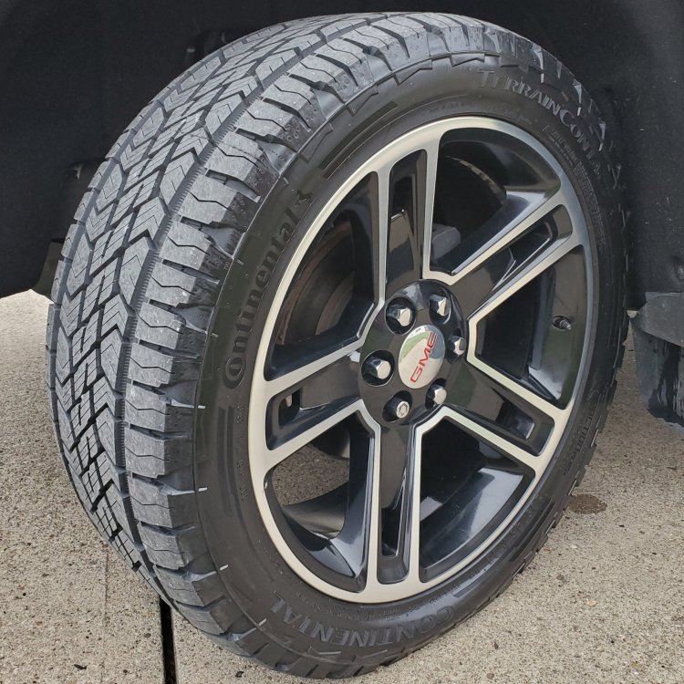

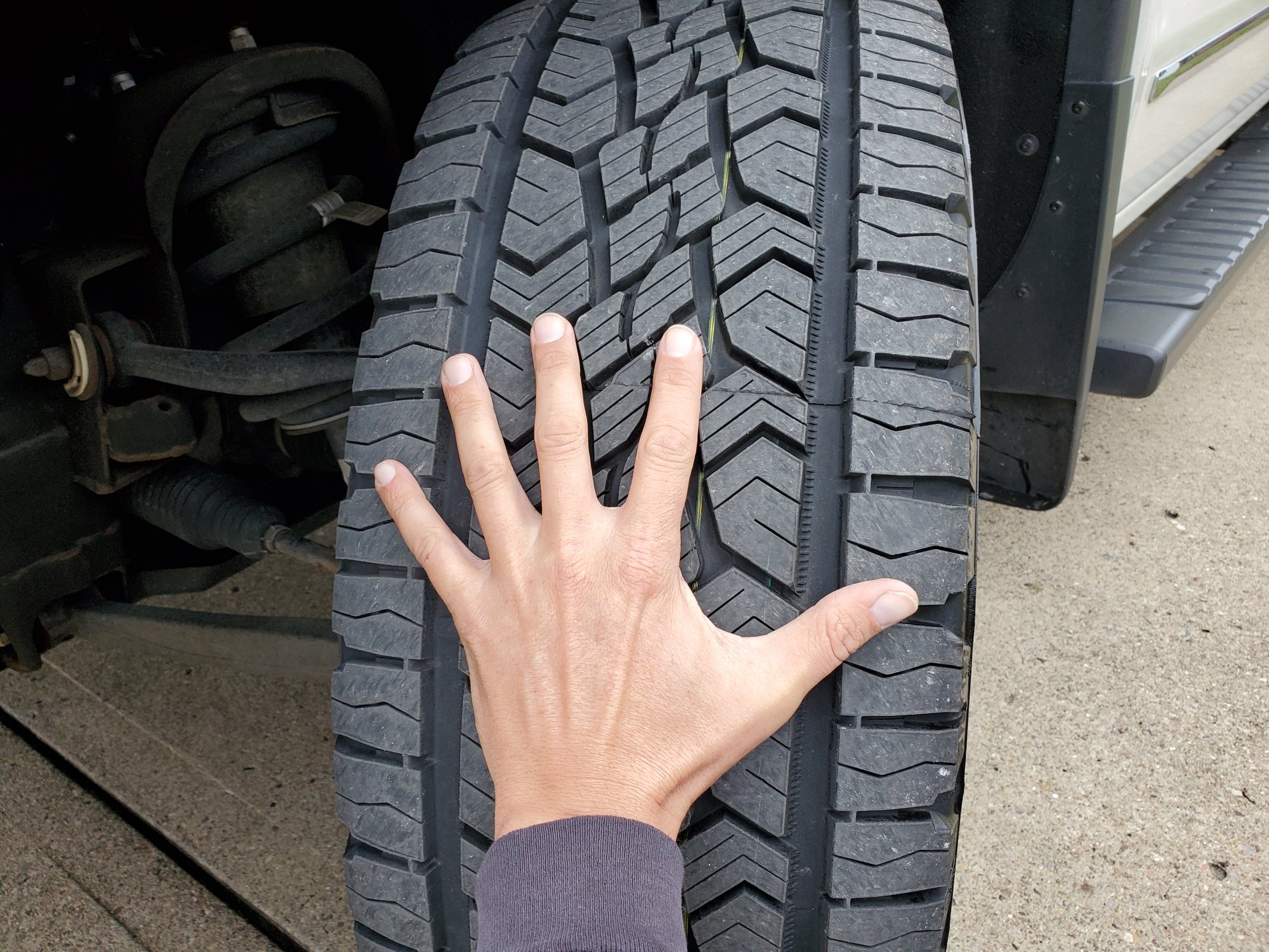

  12. If it snows, I'm poised to have a good opportunity to try them in "first tracks" conditions. Part of my responsibility at work is over night snow removal, so when I get called in, the snow has fallen, and I'm the only one out on the roads. Plus regular trips to ski resorts with the kids around the Mid-Atlantic. Definitely not paid. I have no dog in this fight, and to be honest, these are the first set of Continentals I've ever bought. I've had 37" Bias ply Iroks, drag radials to z rated gumbands and budget A/Ts over the years. For a daily driver, these may be my favorite tire thus far.

  15. Earlier this week I had the Continental Terrain Contact A/T put on the truck. They were replacing the Nexen Roadian HP's the previous owner had installed. (The Continentals are considerably wider than the Nexens were, in the same size) I ran them down to 2/32" to get as many miles as I could out of them. With winter coming, it was time to make a move. After calling around and taking into account the rebate, the dealer was the cheapest, much to my surprise. I've only had them on about a week so far, still messing with tire pressures to get an even tire wear using the chalk method. But so far these are the quietest A/T I have ever had. In rain it feels like they are glued to the street. On dry pavement they a have very firm (not harsh) feel. Response is dead nuts on with no wonder. I have a 1000 mile trip coming up in a couple weeks, through the mountains of West Virginia that should give a wide variety of driving conditions, so I'll report back after that. But so far initial impression is very very good This is a pretty mild A/T. It fits the vast majority of truck owners that spend much of their time on the road and a little bit in grass, dirt, gravel roads, etc. I spend most of my time on road. But often find myself in grass, gravel roads, loose dirt etc at camp. So having a tire that's civilized around the city but still capable at camp/farm was important. And this was exactly what the tire was designed for. So far, I'd have to say Continental hit a home run here. In 285/45/22, they are middle of the pack as far pricing goes. Now they don't have the 3peak mountain symbol, but I'm not at all concerned about it. It's a very good tread design that had proven to be very capable in snow in Tire Rack testing. I will update this as winter goes on and the snow falls, but I am expecting them to do well... Here are pics of them installed on my 2015 Crew standard bed.
