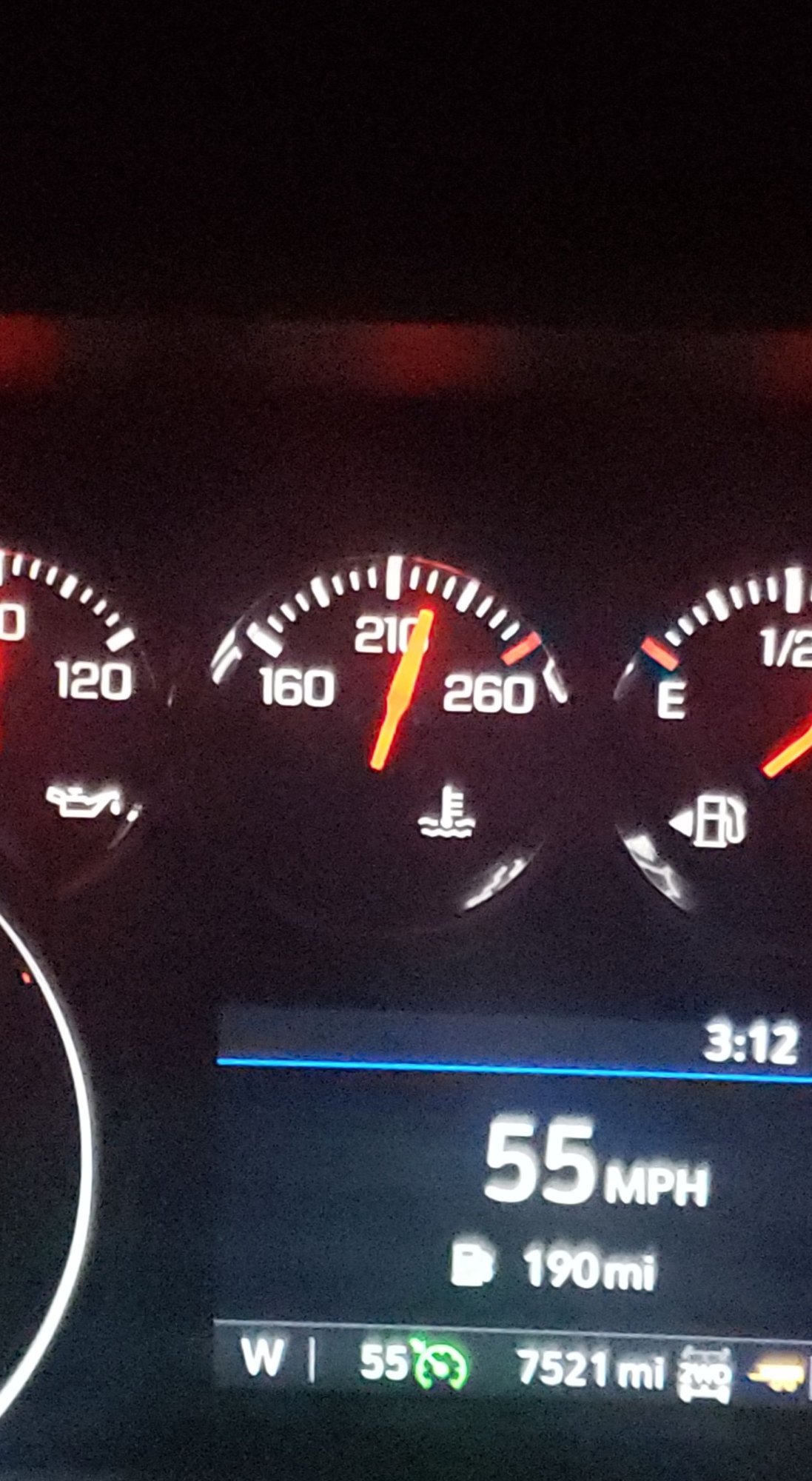

  5. Usually it'll come back down to "normal" "210" within a min or two after we get back to a steady lower rpm and arnt pulling a grade or running 3000rpm under higher load.
  6. Trans temp was in the area of 170 and 180 when this happened the few times.
  7. Hey everyone. Say I'm just looking for insight or advice to weather or not this is common on these trucks or not. When I've been pulling 2 SxS on an 22 ft trailer with equipment roughly 5500-6000lbs total running highway speeds and getting into some rolling hills and rpms come up a little like dropping 1 or 2 gears in the 10spd trans I've noticed my coolant Guage going up to what I would say is 230. Now my old silverado never budged past 210. Not sure if these gauges are more accurate or if yall think I have a cooling problem. According to my build I have the HD cooling. And honestly it hasn't been that warm out either, I just figure I'm only 2/3 to the capacity of the truck and I wouldn't expect it rising like that.Any input would be grateful.
