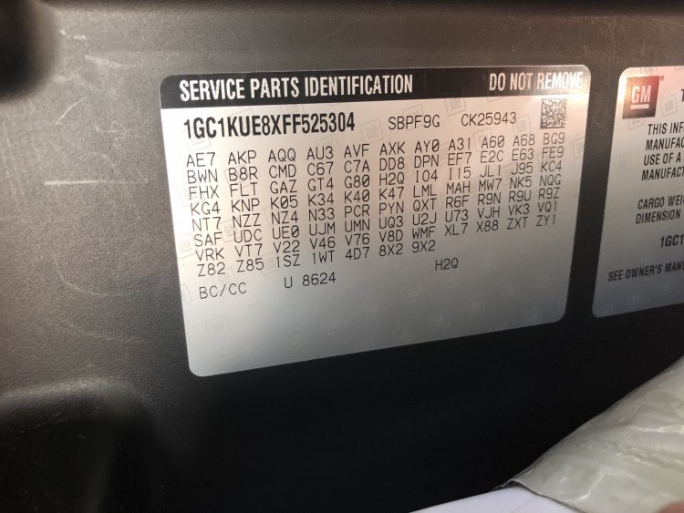

  1. Honestly, not sure if the truck came with OnStar. Never subscribed to it. I took some photos of options sticker and interior for further reference. The Bluetooth input/output on voice worked fine with original IO4 so I’m stumped as to why it’s not functioning now. *tried uploading photo of mic above driver side visor but wasn’t successful. It’s there though.
