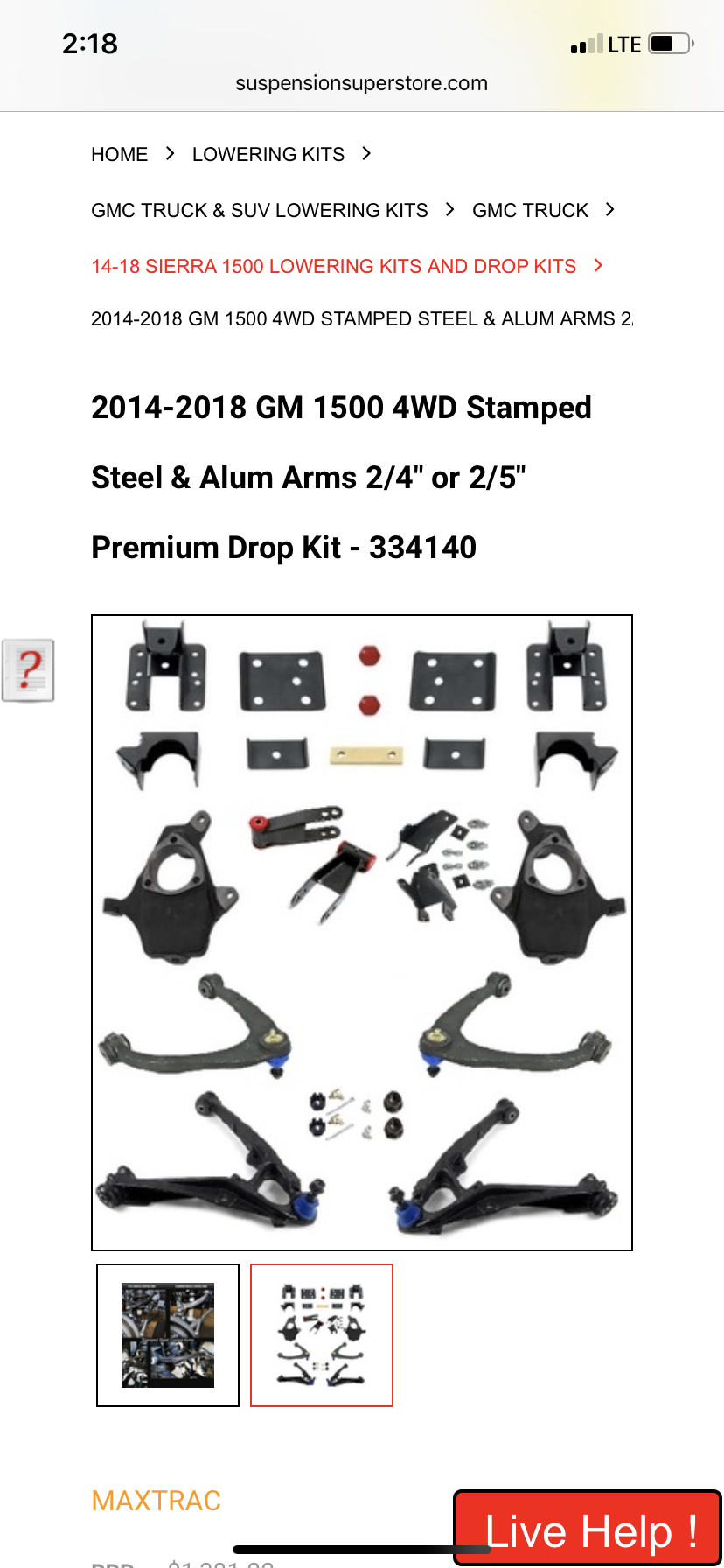

  6. This seems like the most complete pkg I’ve seen. Does anyone have experience with it?

  9. Hoping for input on some options I’m looking at for dropping the Sierra. 2017 4x4 Double Cab. Only looking for 2/4 drop. Rear will be 4” flip with Belltech shock. Is anyone flip kit better than another? Come with shorty bumpstops? McG front- 2” 4x4 specific spindle with corrective control arm ($860+/-) Belltech- coil over drop with sway bar Belltech- 2” drop spindle, no arms. Includes shocks. Any 4x4 specific input would be great. Leaning towards coil overs but feeling like McG probably got it right with the spindle/arm combo
