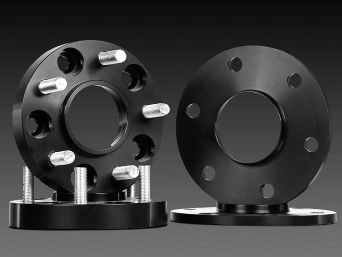

  1. They are both, I bought .375 BORA hub centric spacers from Custom Offsets. They look just like the ones on the right in this pic. Just plugged in the truck info and ordered what came up. The image on the site shows a 5 lug. But it warns that the image may be incorrect. They were perfect, thick enough to accomplish what I needed, thin enough to use stock lugs and studs. I'm averaging around 15mpg. But I drive it like I stole it. Hard on the gas, hard on the brakes. I know I could get better if I kept my foot off the floor.

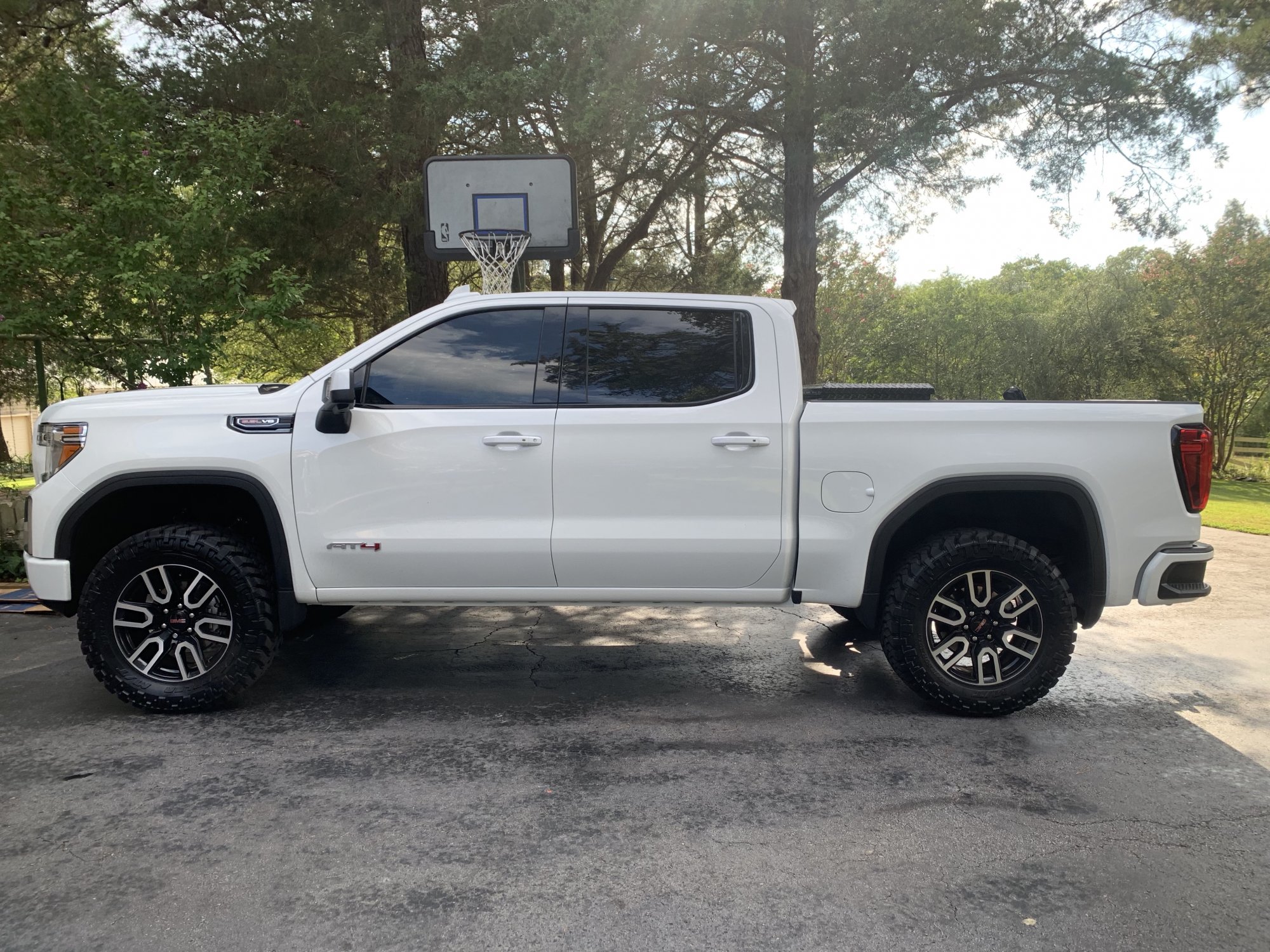

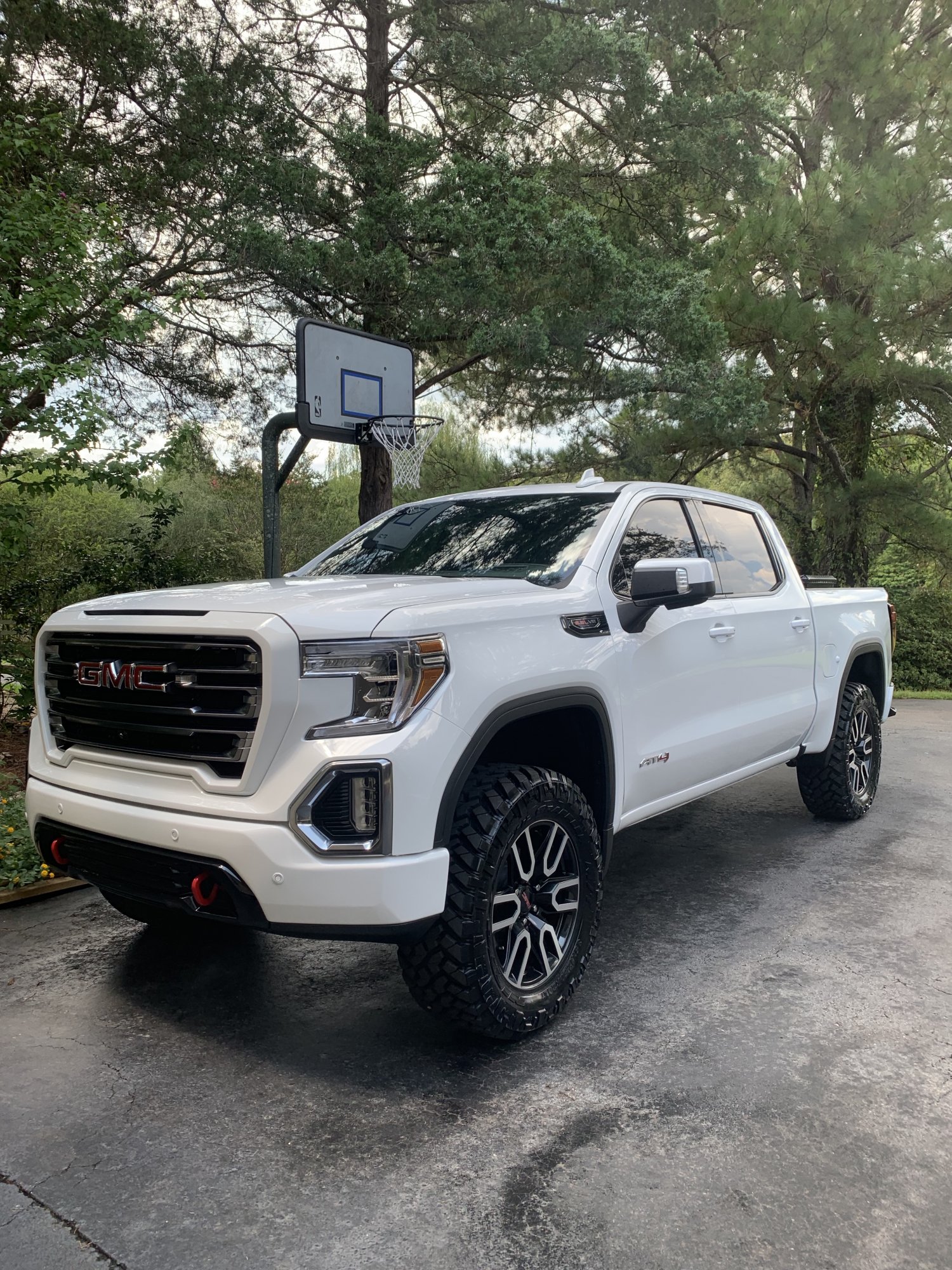

  2. No rubs, lock to lock, forward, reverse or sharp curbs or driveways. Now you will have to "massage" the liners and mud flaps. I trimmed, pushed, pulled on plastic the liners for sure. But you gotta break some eggs to make and omelette right? I went 12.50, going with an 11.50 would lessen this I feel sure, but where is the fun in that? I love Nitto Mud Grapplers. I've had 5 sets on 3 different trucks. Can count on 50k plus with good rotations, pushed 70k on one set but they started to crack. Road noise is average for a mud tire but can kept it to a minimum with rotation. Wait to long and they will HOWL when you move them. Typical for aggressive tire tread. I try to rotate every 5000 or so. My current AT4 has 35x12.50x20's. If you go my route, plan on the spacer as a must. Without at minimum a 1/4 shim the lugs on the inside sidewall of the Mud Grappler rubbed the upper control arm just a touch at full droop. I drove it for a day and never heard or felt anything but had seen how close it was and got the shim/spacer immediately. I don't care for too much "poke" so no big 2in wheel spacers for me. I prefer the tall tucked just under the fender look. I used a 3/8in one with factory lugs and studs.

  10. No guts no glory. I went ahead and did the Rough Country 1318 2in level. It was anything but level. It had had the front up an inch higher than the rear. So out go the factory AT4 blocks and in come 3in ones. Sits dead level now. Went with 35x12.50x20 Nitto Trail Grapplers. Was a little nervous since they measure and true 35in and 13.39 wide. A 1/4 spacer was needed on the front since the width of tire was causing a light rub on the upper control arms. Removed the mud flap bracket, trimmed the mudflap, and pushed and pulled the liner out of the way. No rubs, lock to lock now.
