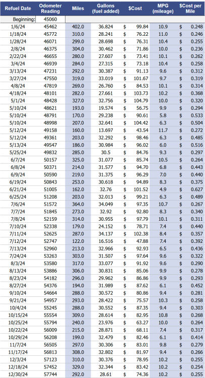

  1. The comment about this article created by GM was spot on!!! lol I still have the same issue/experience. I can positively say in my situation, the oil consumption I experience is directly related to my towing. I still try to drive the speed limit on the interstate where there is minimum traffic and the truck does not like it! With wind I sometimes get 4 MPG!!!!!!! oddly enough, if I tow a utility trailer that weighs almost 10K versus my camper which is only 7K and the difference is huge! Guess that wind sail makes all the difference. Happy towing everyone!!!!
  2. So your saying I should put a hitch on my vette to take advantage of the aerodynamics for towing........
  3. I'm pretty sure the "best" was downhill with the wind at my back!!! lol 12-14 is what I usually get on the highway unloaded

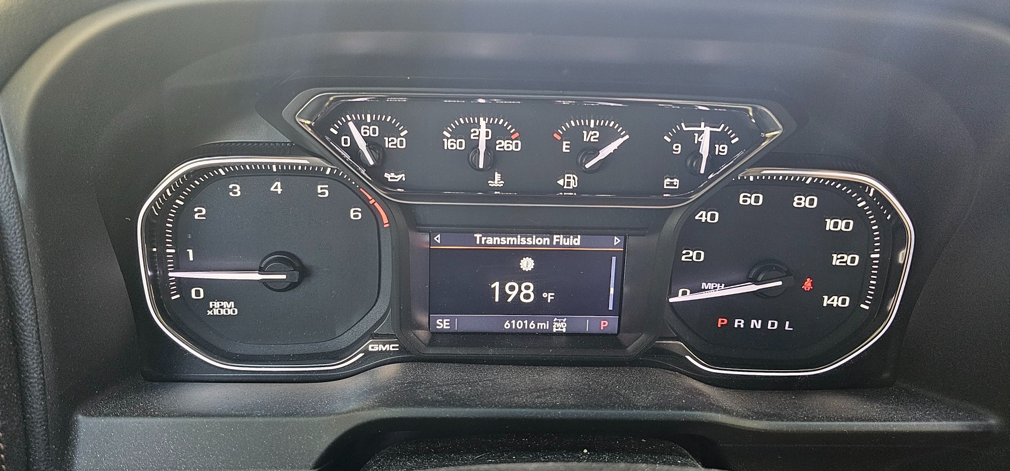

  5. This is my trans temp unloaded, also posted a pic of the ambient temp. At least my MPG's are up! lol
  6. No stepping on toes here, I welcome any and all info and opinions!!! Down here in Corpus, I don't think I've even had my trans temps that low. Even on my wifes SUV which is a full size it flirts with the 180-190 range

  9. Not sure what oil temp was but I monitor trans temp at it was steady at 196 degrees. It does creep up to 206 in stop and go traffic but comes back down. While driving without a trailer its usually around 185-190.

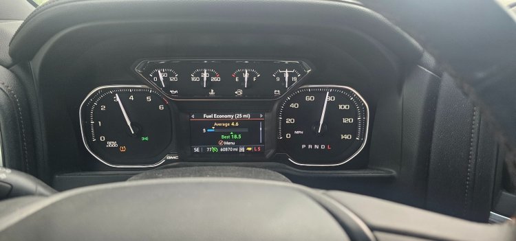

  10. Here's a minor update. Last oil change was 3/7/25 @ 59,261. No longer using this truck as my daily driver, its only driven when "truck" abilities are needed. That said, checked oil on 6/17/25 before a camping trip and it was a qt low. At that time milage was about 60,518. This still falls below the threshold that GM says is normal (1 qt per 100 gallons of fuel). Here is a screenshot of us driving home southbound on I37 outside San Antonio to Corpus......Now before I get ridiculed for driving too fast I really don't see an issue driving the speed limit while towing. The traffic was minimal and there is absolutely no sway but the MPG's are insanely low!!! This may not be the right place to ask this but does anyone else get this type of fuel mileage??? My camper is not heavy but it guess it likes to catch wind. Truck constantly down shifts on minor hills, I tend to keep it in L5 that way I can lock it in 4th to minimize shifting with the press of a button, then back to L5 for straightaways.

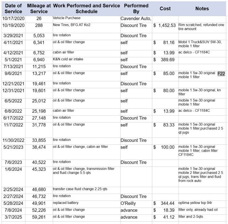

  14. I have always used Mobile 1 full synthetic and a mobile 1 filter. here is a screen shot of my maintenance log and fuel log for reference.
