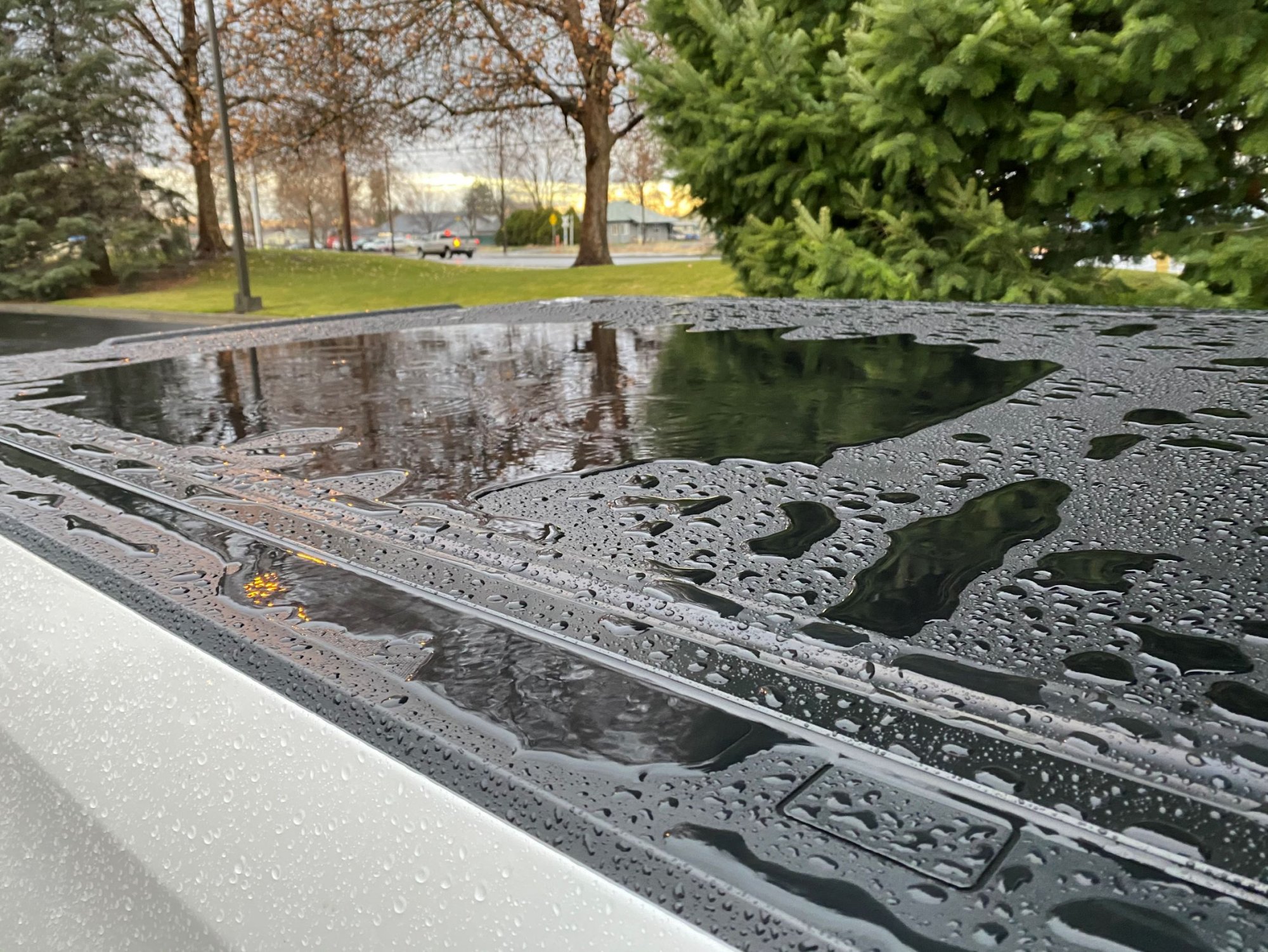

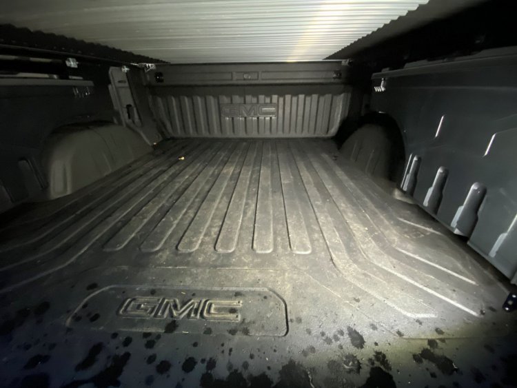

Since I have the cover on, you cannot see it really. But if you went to the dealer, you can see how the bed rail cap, and how it sits on top of the metal, and the seem between the front of the bed and side rails have places to leak. When I had my tri-fold cover, the local GM acc rep and the main GM acc guy flew in from California to look at things since there was my truck and another identical truck, both had the same tri-fold REV covers, both leaked. They had my truck for 3 days, they added black silicon all over those gaps, but still couldn't seal the bed rail on top of the metal, unless you take off the bedrail plastic (which you would need to replace as it would break taking off according to GM) to seal under it. I may do that, but with just the foam strips that come with the bed cover, it will leak some in the corners. For complete, no leaks, I have heard that the fiberglass one piece are the way to go.
I went from a 2005 Chevy Avalanche to my 2019 GMC Sierra, I too was disappointed with the leaking. But, the biggest deal I see is how the bed is constructed on the new 19's/20's, they seem to have overlaps in how they are put together, allowing water to seep in the corners, especially the front of the bed. Nowhere near as sealed as my Avalanche was, but then again, that was designed from the factory to seal, where the pickups are not designed that way. My thought is as long as it is not waterfalls, and only in the corners, me personally, am OK with that. The issues I had with the tri-fold from REV (GM acc), was the leaks through the panels, so switching to the rolling hardback helped, a LOT.
