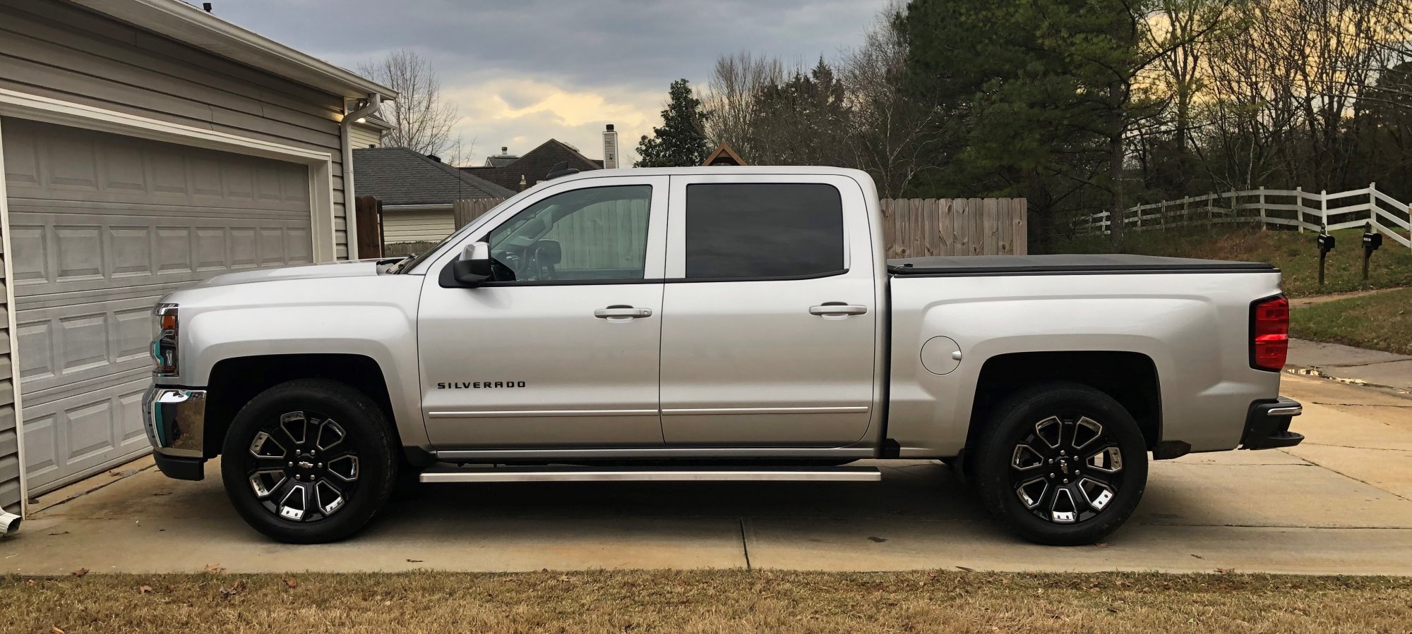

  14. I am running 275/55/20 tires. Which is the stock size for 20s. The ONLY mod that I have done to my suspension is pulling the rear lift blocks. 2 Photos attached. The one with green grass has the lift blocks still in place. The one with the brown grass the lift blocks have been removed. You would be surprised how much pulling those blocks will level the truck out. It is not level but it is a whole lot better than it was.
