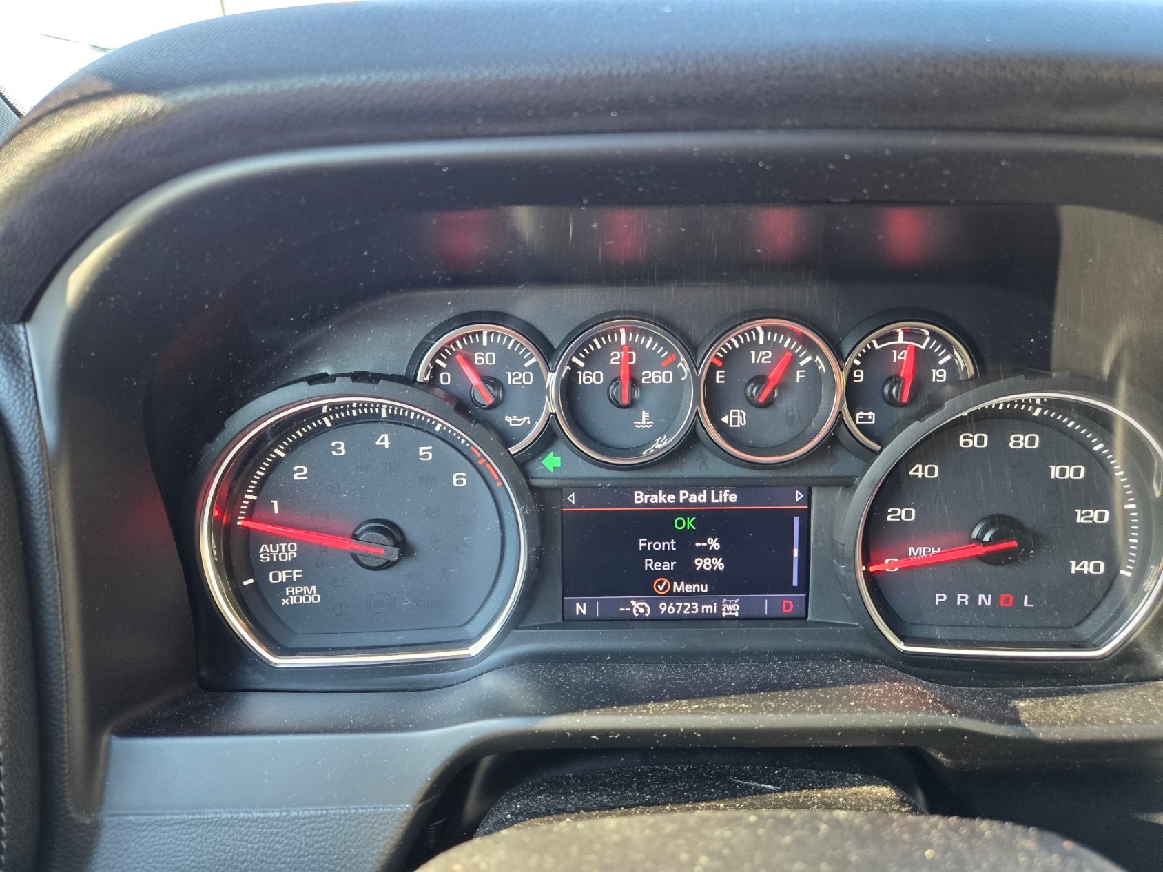

  8. Just got my brakes done on all 4 wheels less than six month or go ago including rotors and new brake pad life sensors. Brakes feel and work fine. Just recently I started getting this intermittently. Notice the ---% on the fronts. After a while driving it was toggling back to 97%. Anyone else ever see this?
