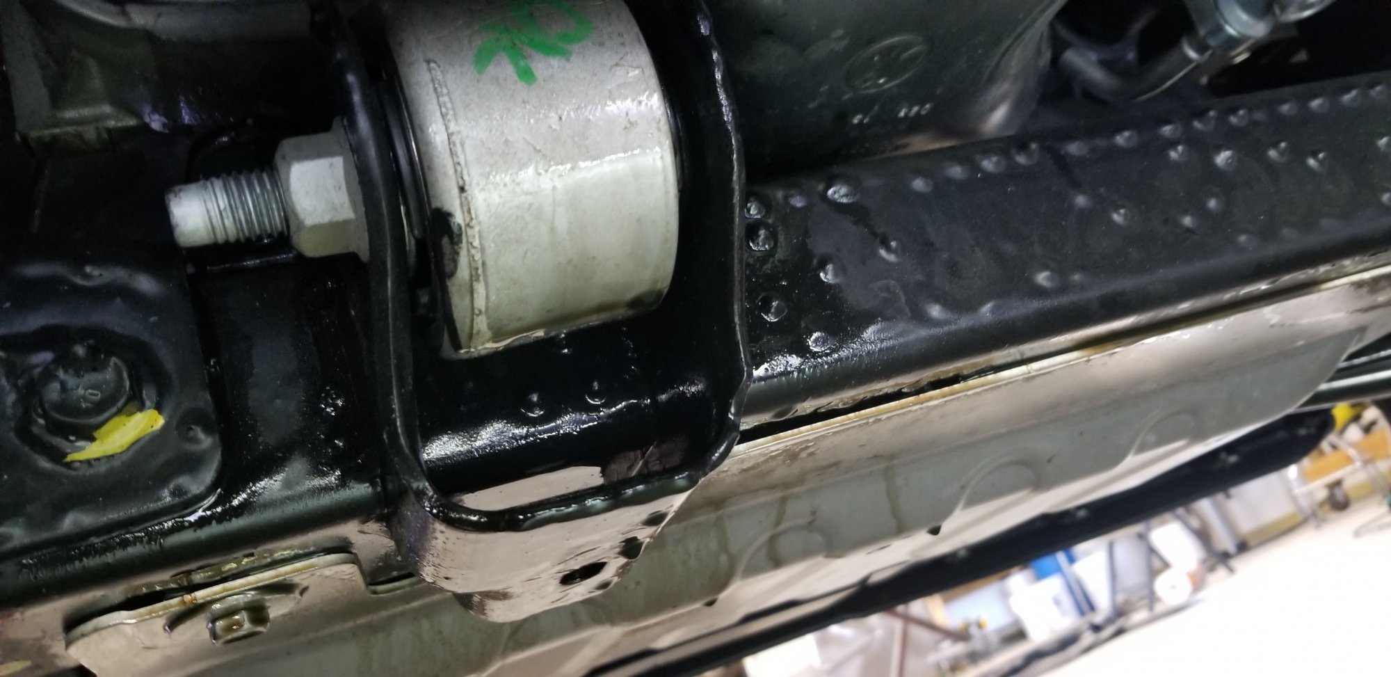

Turns out it's a seal that goes from the intercooler to the engine. The seal isnon order...should be up and running Monday. My dealer has been great! -

It's not as bad as I thought. I got the truck towed to the dealer and had them drain the oil with me present so I could see how much it had left in it. It still had about 5 quarts (it takes 7). The oil was clean. The are now figuring out where the leak is. I will update when they find out. -

I am going to let them check it over. Its definately not the oil filter or the drain plug. The leak is somewhere above the oil pan. I could not see where it's coming from. It's just leaking a lot of oil. I will update when they tell me what's wrong. It's just incredibly frustrating to have a new truck with 300 miles on it and having a problem like this. -

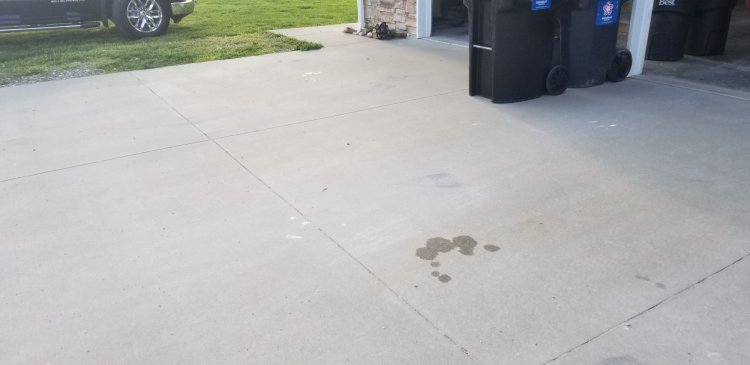

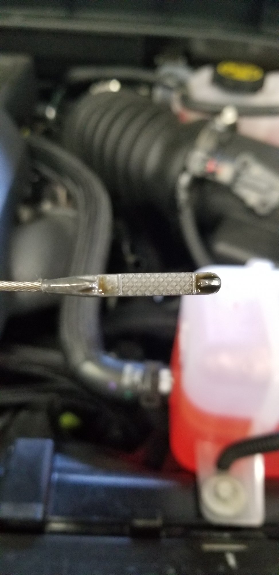

So, I just bought a brand new 2020 Sierra SLT with the 3.0 Duramax. I drove it home last night from the dealership. It had around 200 miles on it when I picked it up. I drove it all day today and put about 100 more miles. The odo shows 316 miles. I parked it on my concrete garage pad and went into my garage and saw fresh oil on the garage floor where it had been parked. I looked under the truck and saw it dripping oil onto the garage pad. Then I saw another spot where I parked it yesterday for a short time, again more oil. I look under it and saw oil coming from somewhere above the oil pan but could not pin point the area of the leak. I then checked the oil and there was only a small oil mark at the very tip of the dipstick. I have to assume it's been leaking since it was built. There were no warning lights and it seems to be running fine. I did notice that the engine oild monitor showed only 75% life left? The dealership was already closed for the day. Any suggestions? I dont think I want a brand new truck that's been run dry of oil. Should I ask for a new truck or should I have this repaired and take the chance of future issues?
