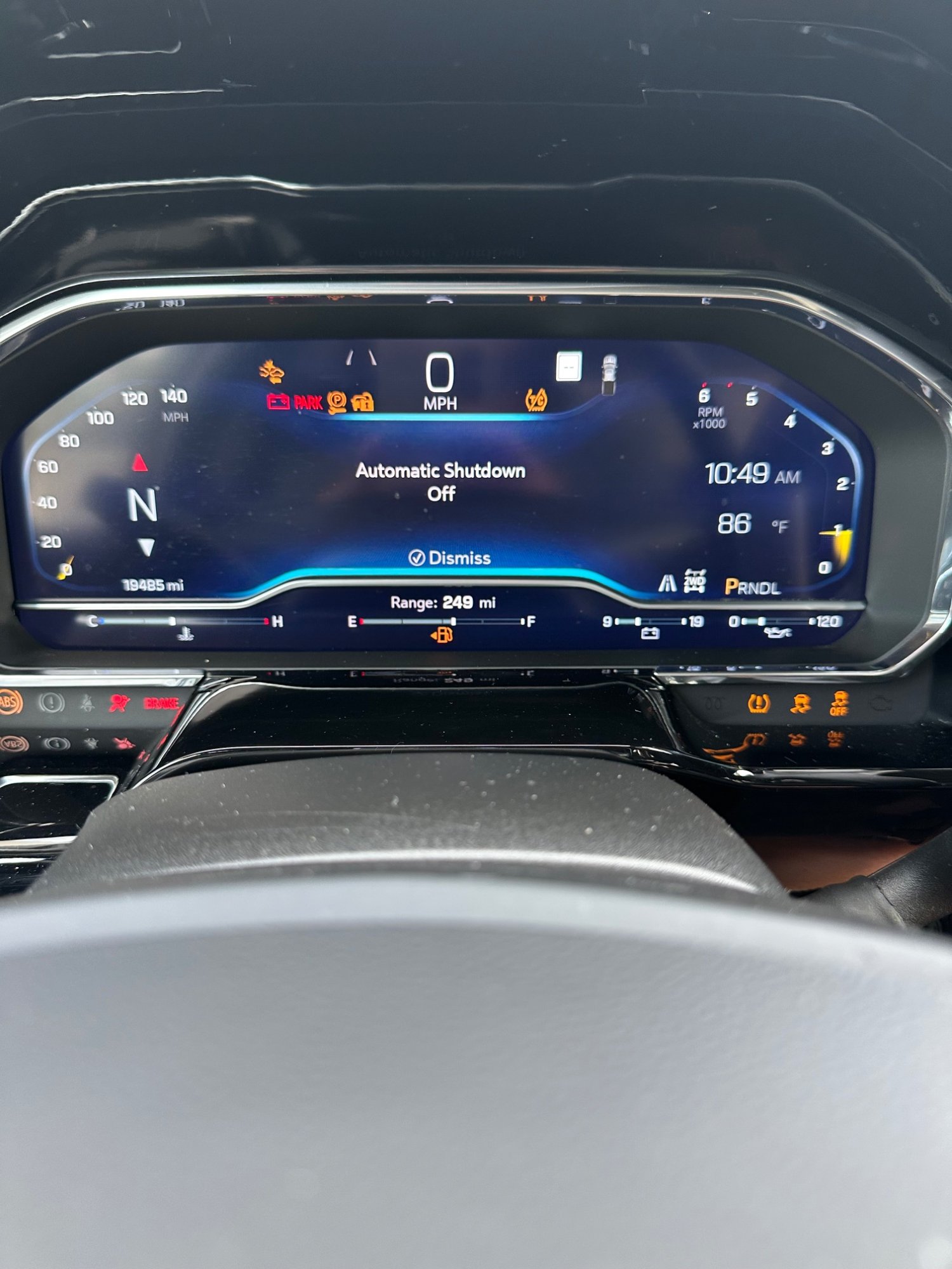

  3. My truck is not listed in that TSB, as it's a '22 refresh...but, it only showed up when they went to program the second key...but, here's what I learned from the dealer yesterday... When programming a new key or doing other things with the computer, there is a "security" window that you have to wait through to get things done. It could be either ten minutes or over an hour. The service guy said that when doing that, it will enable that feature for up to 24 hours so the truck doesn't turn off when doing programming of some sort. It went away on it's own yesterday and hasn't been back on since. Whether the dealer was right or not, who knows...but it's gone, and I'm able to turn it on as I wish for just a single ignition cycle, if needed.

  5. Okay y’all - I have a tricky one. Last week, I bought a pre-owned 22 LT with the refreshed interior. Love the truck and features and all that fun stuff. As the truck only came with one key, I went to the dealership today to have the second key made as part of the deal. I didn’t catch this when I left as the truck was driven up and brought to me and left on, but when I left and started going other places, I noticed now every time I start the vehicle, it says “Automatic Shutdown - Disabled”. I’m aware of the feature but was reading that I’d have to do this every time I start the truck, but, it’s on by default now. I don’t mind the feature being on, but, now I have to dismiss the screen every time I start the truck. I think it’s odd it started after getting a second key programmed and added, but, no idea why. Anything I can do at home or is a trip to the dealer needed to reset this using a scan tool?
