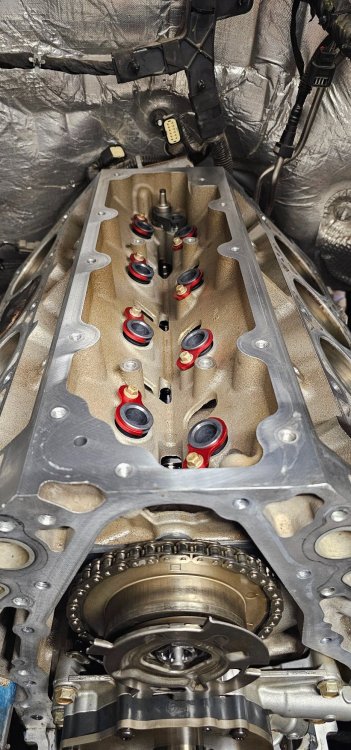

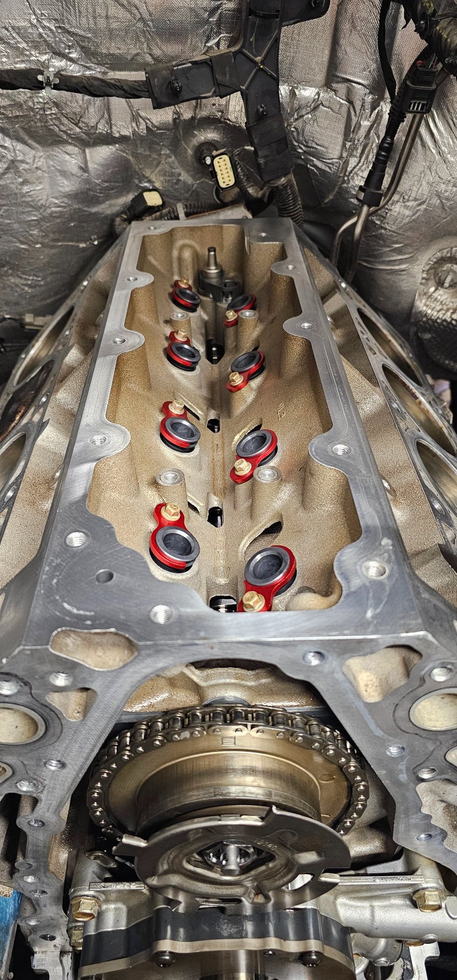

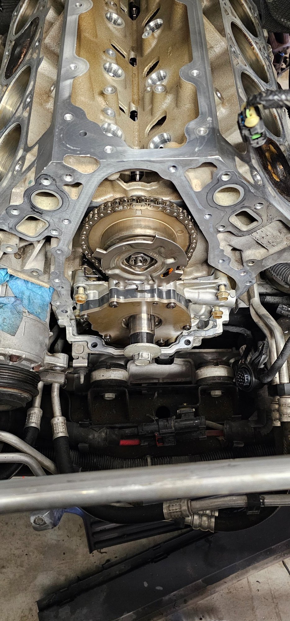

  3. Here's proof you can do this with out a pan drop or pulling the oil pump forward. Going back on was easier than removal. Nailed the orientation in 1 try. New cam and retainer plate installed prior obviously.
  4. Your cam is obviously waaaaay worse than mine. I'm going to do this myself and highly suggest you do it as well... get 2 oil change kits. Before you start it up again change it. Run it for a bit, let it get up to temp and then drain and change oil and filter again. You do not want any of those particles in between your friction surfaces. I unbolted the pump but didn't slide it forward. It let it wiggle a tiny bit but I did not want to mess with that seal on the pickup. Looks impossible to replace if you screw it up. How did you slide the pump forward at all? it seems locked in place because of that seal the the dowels. What were your symptoms prior to tearing into it and are you going back stock or delete?
  5. If you're going to be installing it, go ahead and delete all the DFM stuff out of it before you install it. Will be 100x easier on a stand than doing it in the truck.

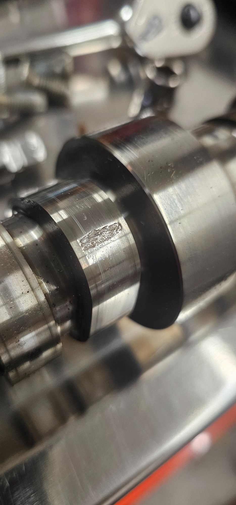

  7. If you heard lifter noise (tapping) a week ago you should have stopped to investigate it then. It was in the middle of grenading itself and you kept on driving it. What happened more than likely based on your description was that one of the DFM lifters started to fail (known GM issue) and started to gall. It quickly spread the contamination through your engine and ruined the bearing surfaces. Pull the oil filter and cut it open. I bet if you remove and spread out the element it will look like you found gold on the Yukon river.
  8. It was unlocked but I didn't rotate it to get the chain off. Once I turned it to where I needed to get the phaser plate out of the way that's all I needed. That allows it to drop down just enough to get this to work. I haven't reassembled it yet but I will be locking it back before I attempt it. This way I know it's right when it's back on and the arrow is pointing straight up.
  9. Stop what you are doing and put the #1 piston back at TDC and at that point the arrow on the cam gear should be pointing straight up at 12 o'clock. Then go back under the truck and install the lock that bolts where the starter goes. From there mark across the flex plate and onto the lock tool with a sharpie or scribe so when you go to put it back you aren't depending on the timing chain marks or something else that could move if you drop the chain or it slips a tooth on the crank sprocket. After that remove the cam bolt and turn the crank to about where you have it so that the phaser plates notches straddle the oil pump like you have pictured. From there pull out on the cam gear until it disengaged from the cam and drops down a little. DO NOT pull on the phaser plate. You can pull it apart fairly easily. There is a clock spring type setup in there and you can not put it back together if you seperate it. You will have to buy a new one and they aren't awful expensive but still around $200 I think. You already have the tensioner release I see so your next step is to grab the chain on the drivers side and lift / pull on it until you get all the slack available on that side. Once you do put a sturdy pick or screw driver around the 2:30 / 3 o'clock position and gently pry the chain back in a manner that is trying to push the chain behind the cam gear. You will know if you have it right as a little pressure will just about allow you to put the chain completely behind the gear. Once there take a 2nd pick tool and walk it one tooth up. Repeat this until it walks off the back of the gear. It took me 3 moves once I found the right spot. It will take some light force but certainly nothing that feels excessive. If you are going balls out trying to pry it off you aren't in the right spot or have it setup right. After it's off put #1 back at TDC and reinstall the lock tool where the starter goes while paying attention that the marks you made previously are lined up. When you reinstall the gear make sure when it's on that the arrow is back at 12 o'clock.

  12. Well well well.... finally got it all the way down and lookie what I found. An initial visual inspection of the lifters didn't yield any obvious clues but when I pulled the cam out.... So to folks who say tapping noises are nothing to worry about... I was definitely on borrowed time with this engine.
  13. Put the piston at TDC and it won't be able to drop in enough to lose it. Can I contact you? I've got some questions about my own dfm delete going on.

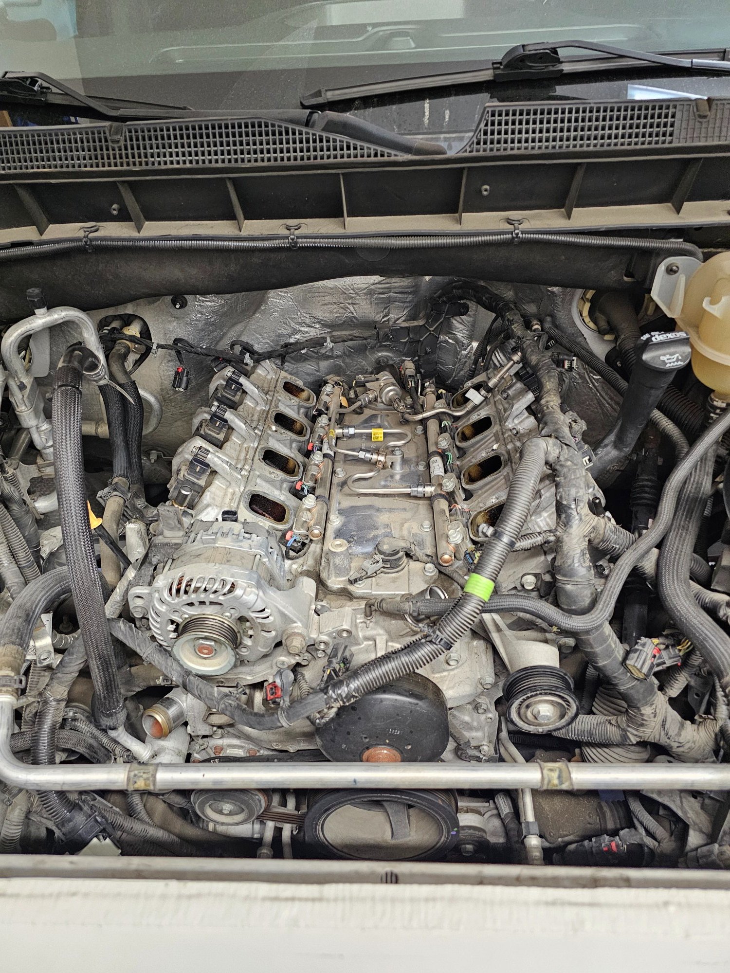

  15. You're going to have to pull the radiator and fans for sure to get the cam out. It's not fun. A/c condenser and trans cooler can be left in. Separating them from the radiator is fun.
  16. Well, I'm almost all the way down. Last hurdle is to get this cam out without dropping the pan. Seems to be easier said than done. I've got the tension off the chain but I will can't walk the chain off the cam gear. I've watched some videos and get the idea but I gave up for today.

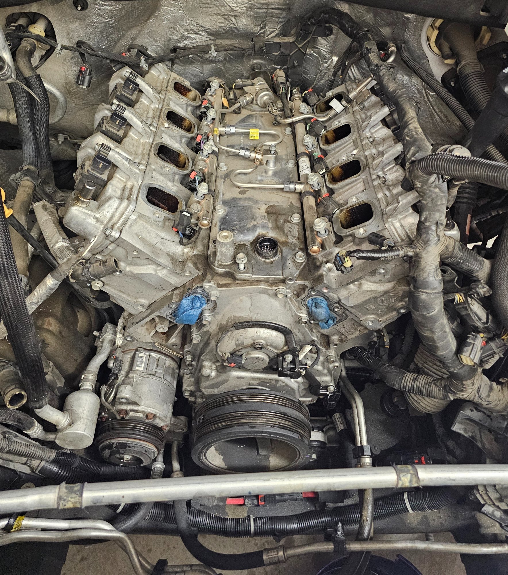

  21. I've already sent it to HP tuners for the unlock. Once I get it back and it's ready to start it will have to go in and turn off the DFM and while I'm in there the auto stop / start. Any reason for the weight change on the oil? Yesterdays progress, remove the front accessories. I'm not in a rush on this. Truck is paid for and I have a spare vehicle. I just do a few things a day and in a few weeks it will be done.
  22. That's my thoughts as well. I ordered a whole delete kit from Texas speed and have begun tearing into it. It's not a fun job so far.
