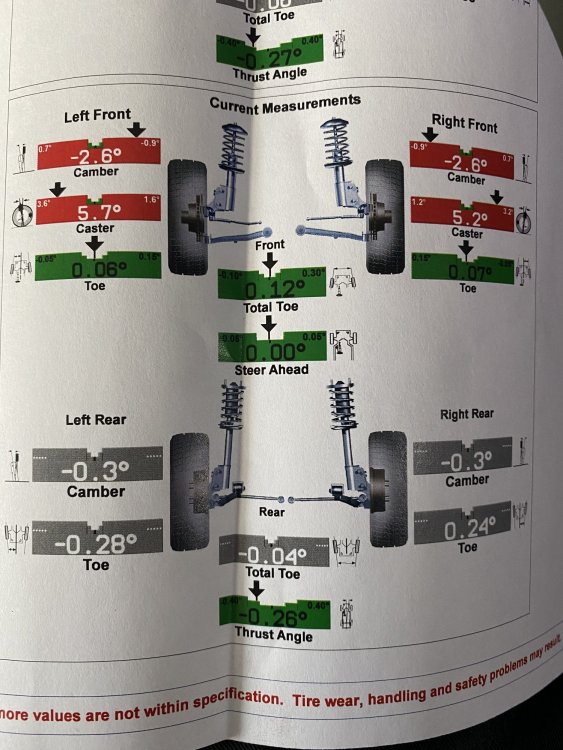

  3. I’ll go back to shop, l was thinking about probably they didn’t put a right bushing in or something. This is a picture after the shop installed the kit before getting the alignment done
  4. l recently purchased a 2014 single cab silverado truck with 2” inch spindles and springs with a flip kit that made it into a 4/6 drop. I wanted to fix my camber problem, so l was recommended these kit from beltech. The beltech part number is #4957. I had a shop put the part on and, I brought it to an alignment place and they said that they couldn’t put my wheels straight and my eccentrics where already maxed out. Any thoughts of how l could fix this problem? Picture shows how my truck is right now.
