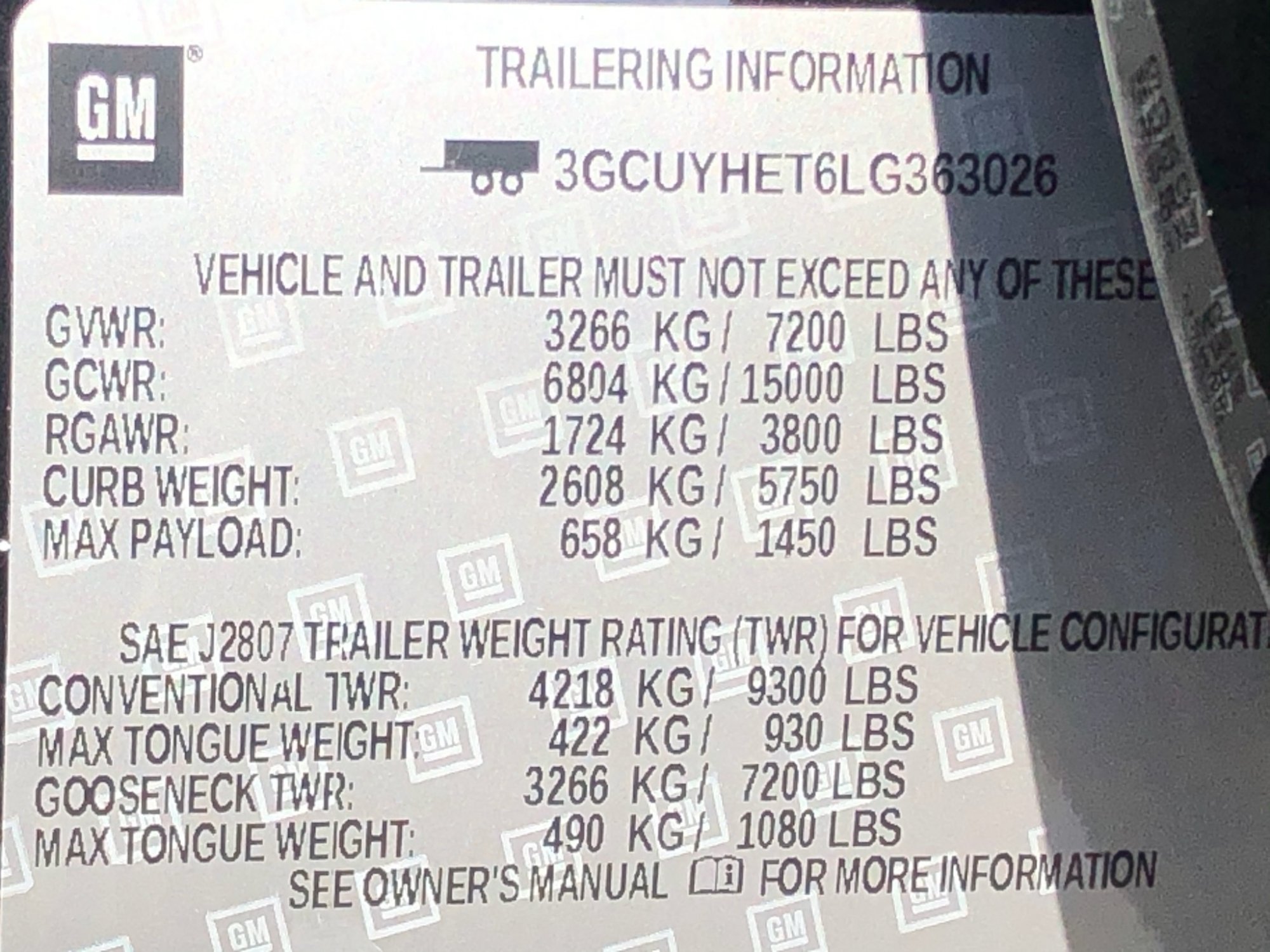

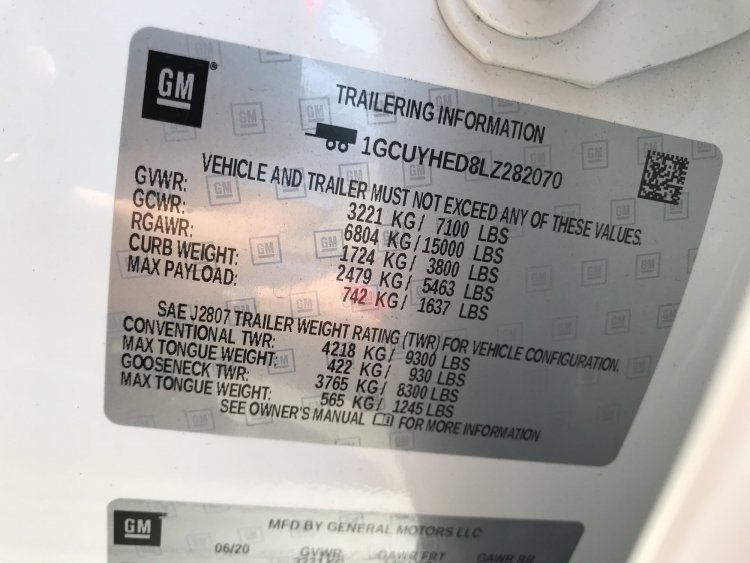

  6. Yeah, good catch. The 144 lbs difference from the 6.2l to the 3.0l Duramax accounted for the difference in the GVW. The door stickers I compared were for a 6.2L 7100 vs a 3.0L 7200, but the 6.2L had 144lbs more payload. finally Figured out how to upload the files. So the first pic I believe is the 6.2L high country deluxe package and tech package, bottom pic is identical except for the 3.0L Duramax, both short boxes. Mind you these are silverados and I even found the GMCs will weigh differently, the carbon bed I think increases payload 40-50lbs along with possibly the carbon leaf springs, but the multi-functional tailgate adds a bit of weight as well. I’ve been banging my head against a wall trying to understand all these payload configurations and how they’re figuring them out
  7. Yeah, I’m finding some discrepancies even with the door stickers. Comparing identical trims on a lot and a standard to short box showed only a 9lbs differnce, when everywhere else is saying it should be 50lbs. Good luck in your hunt. Your other option that I found was helpful was calling dealerships that had the trucks I wanted to compare and having them take a picture of the door sticker and sending it to me. Could help I your shopping if you’re that far away from dealerships. All the dealerships I spoke with were happy to help, but then of course I have been barraged with sales calls ever since.
  8. To add further upon it, looking up that configurator calculator. Going to the 6.2L added 82.8 lbs on the front axle and 2.6 lbs to the rear axle from a base 4.3L 6 speed, I think, but the 3.0L added 183.6 lbs to the front axle and 79.8 lbs to the rear axle. I also leaned the difference in short to standard box is 50 lbs from the configuration page. I was in a similar boat to you, but trying to figure out differences in weight from a standard to short box. Hope this gives you what you were looking for. With that gm calculator, I just flipped through the screens to read the weight differences.
  9. Yes, from what I understood, the payload was higher. Doing some more research on the forums, I came across this configuration builder that lists weight differences. This I found to be huge! https://www.gmfleetorderguide.com/NASApp/domestic/weightcalc.jsp#
  10. Don’t know if this’ll help or not, but I was looking at identical specked Silverado high countries and noted a difference of 144 lbs if my math is correct. Both were identical except for the engines. They were 4x4 short box crew cabs. This was read directly from the “b” pillar door sticker. I’ve been able to call around and asked sales guys to run out to the truck and send me a photo of it.
