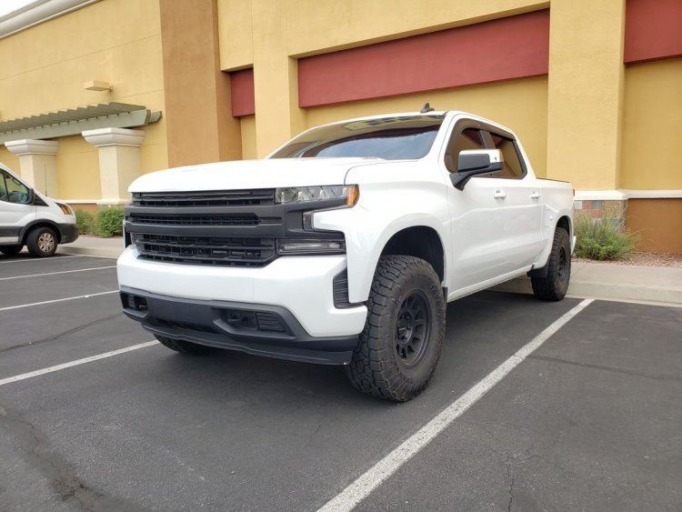

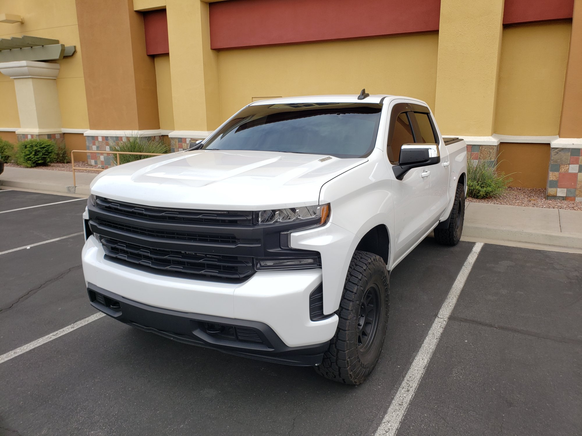

  7. '21 3.0L Duramax LT with diesel off road package (3.73 gear ratio) 2.5" leveling kit 35x12.5r17 Toyo AT3's 17x8.5 Method MR703 with 0mm offset (Cognito standard upper control arms are on their way - don't trust the stock ones) I didn't have to cut anything to make them fit, just removed some parts and ziptied some carpet back.
  8. I have 35x12.5r17 Toyo AT3's and Method MR703's 17x8.5 with 0mm offset on a 2.5 inch leveling kit. I just ordered some cognito standard UCA's because I don't trust the stock ones. No rubbing anywhere after I removed a few pieces and ziptied some back. Didn't have to cut anything.
