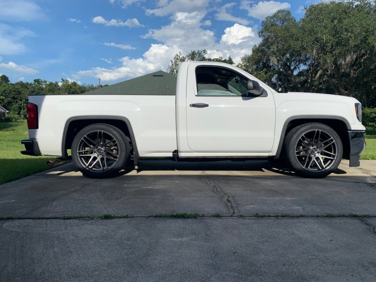

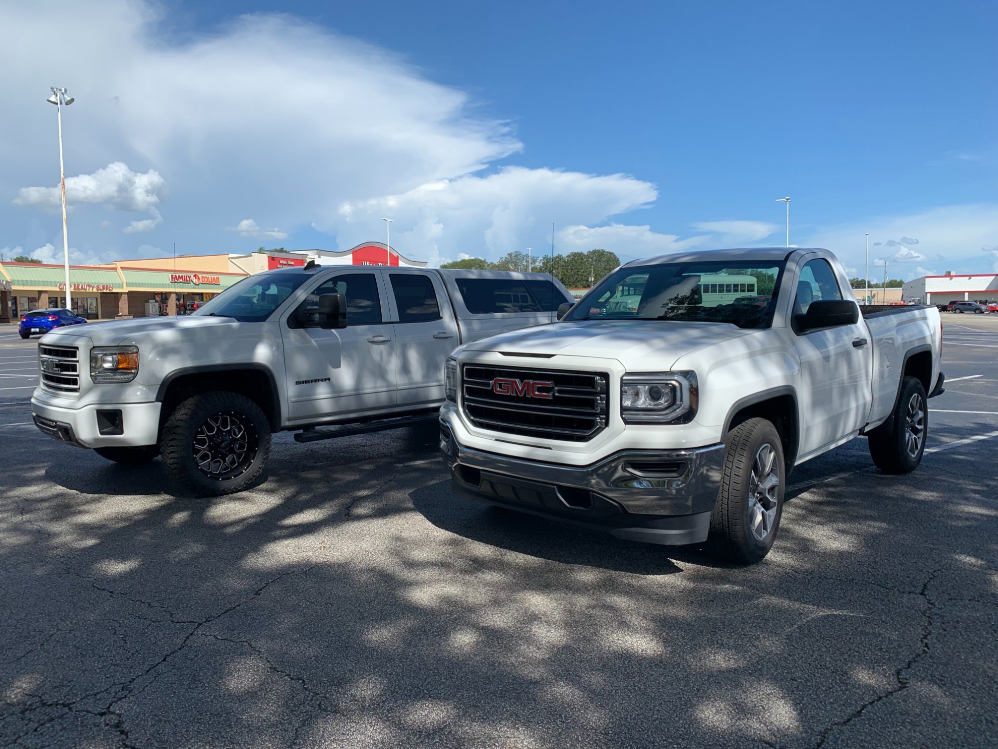

  2. Hey guys. I recently purchased a 2018 GMC Sierra regular cab short bed. The person I bought it from used it to pull a boat and didn't use it too much before deciding to sell it. It only had a little over 25,000 miles. Here it is with its first car wash.

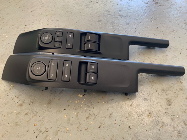

  5. Update to the power window conversion. All is installed and working. I did have to add the two relays I mentioned in my previous post. That way there is not worries about amperage issues. I also molded in the aftermarket switches into the factory trim panels in the doors. In the picture attached, the bottom panel is the OEM. The top one is the one where I molded the aftermarket switches. Everything works great.
