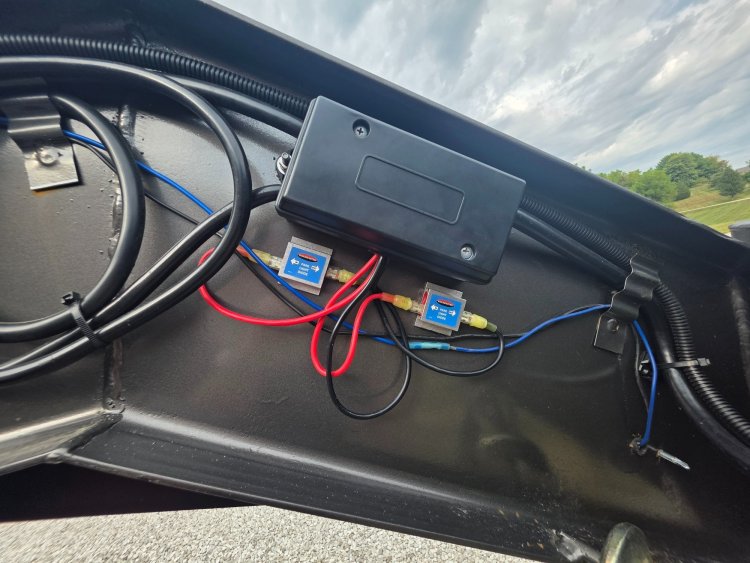

  12. Didn't work for mine. I installed the hydrostar modules on both the 12 volt positive and the brake wire as suggested by hydrostar and my GM dealer. When I left this past Wednesday for an 8 hour trip with the trailer RV still did the brake disconnection went hard on the brakes, when I needed them the most. I forgot the 2022 module that I have at home or I would have swapped that in. There is zero reason for the brakes to disconnect. Even if there is a problem with the trailer brakes the truck shouldn't disconnect. I see it as a major safety issue.
  13. I have a LiFePO4 battery on my crawler hauler. I talked to HydraStar and bought their recommended modules. We shall see how it works next week. I also have a '23 TBCM that is new in the box to go in as well. Hopefully the HydraStar modules work and I can send. It back.

  15. I sent you an email. My dealer told me everything is working fine per their tester on my truck. I know it is not.

  17. I do not have a DC to DC converter. The LiFePO4 battery was completely unhooked but the trailer brakes would still disconnect. The emergency break away battery was still hooked up though. I talked to Hydrastar's tech support. They said in their testing with the 2024+ GM trucks, it didn't matter the type of battery.
  18. I installed the Hydrostar module on the brake wire (blue) and prepped the 12v+ wire module in case it needs it. Hydrostar said I may or may not need the module on the 12v+ between the truck and trailer. I also bought a GM 23306694 brake control module from the '19-'23 trucks that don't seem to have the issue. I found it on eBay for $45 shipped NOS. I've read this was a direct swap and solved the issues. I'm not going to swap this in until the dealer looks at the truck Monday or the modules don't fix the issue. I am still going to take the truck in on Monday to have GM start looking at it.
  19. Perfect. The Hydrostar module is just a diode so I'm going to install one that I have to see if that works.

  21. I have thought about removing it and using the onboard LiFePO4 battery. Does the diode go in the power wire feeding the emergency battery or the blue brake wire?

  24. Where did you install the diode, the 12v+ or the brake control wire? My problem with a DC to DC charger is how my RV has the 12v+ wired. It is wired to the battery side of an auto resetting breaker with the load side going straight to the 12v refrigerator. The wire powers the refrigerator very well. I just drove back from NE OH to S IN today with the battery disconnected from all power in the RV and still got the disconnect message. I have checked all wiring and brakes and there are no problems. My RV is a 2023 with very little miles. I have no solar and a LiFePO4 battery. It did it even when I had the lead acid battery. It doesn't have this issue when I hook it to a different truck manufacturer.
