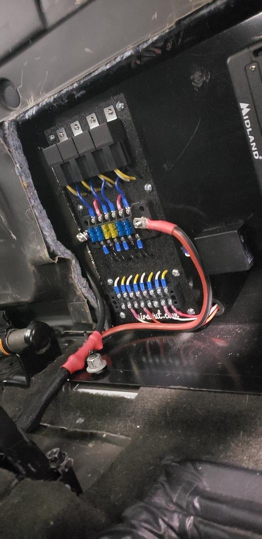

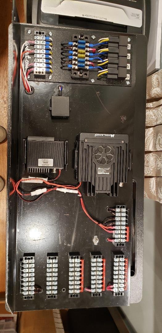

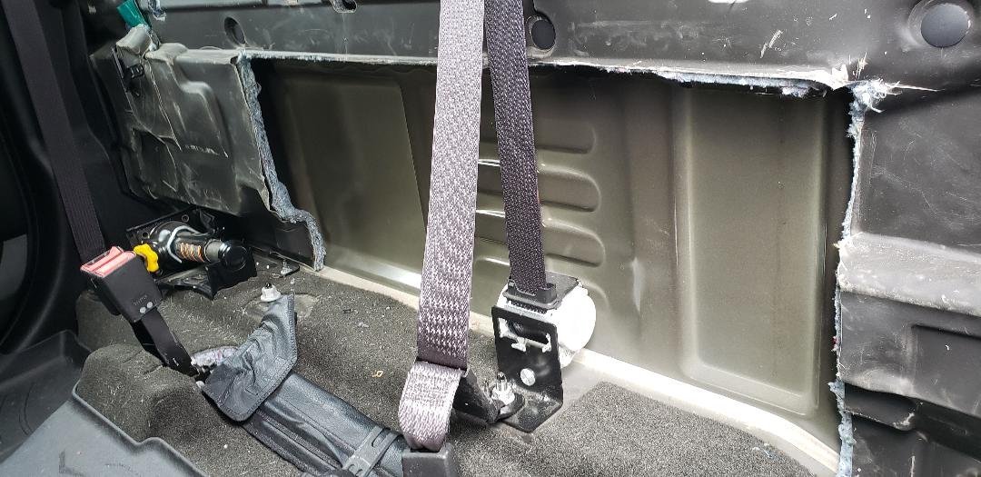

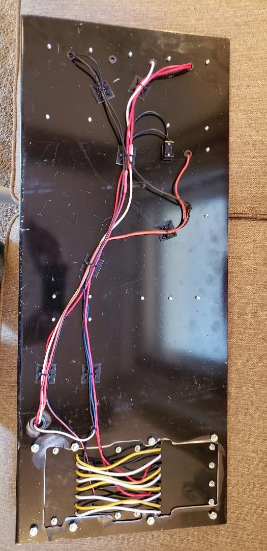

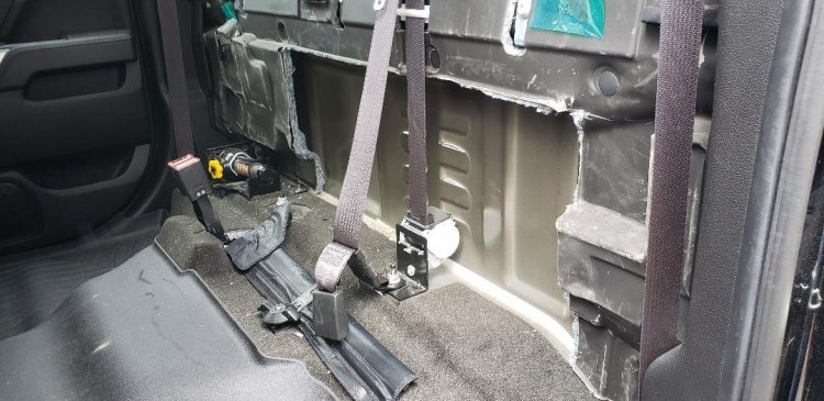

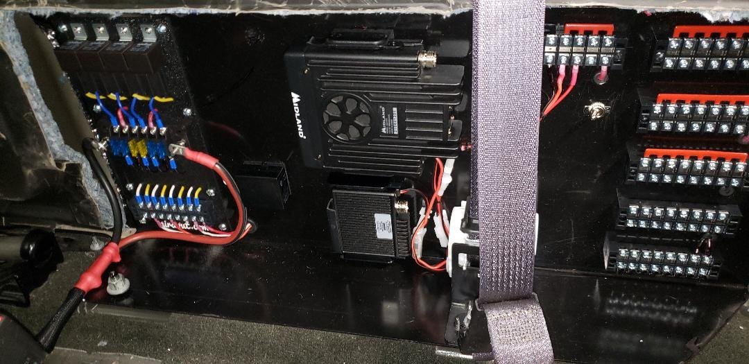

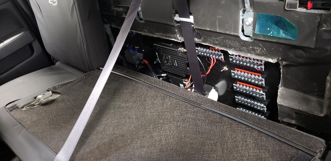

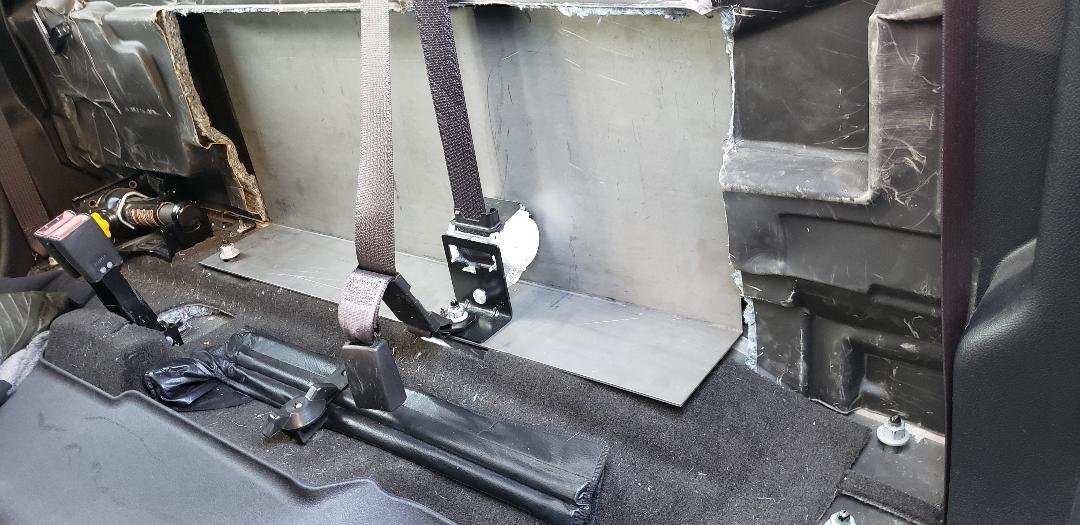

  2. The 2017 Silverado rear seat back doesn't fold down from the factory so when I took it out for the radio install I cut the brackets so it would fold down to give me access to the radios and fuses. I cut out a section of the rear insulation which gave me about 3 1/2" deep area 32" x18" to mount everything. I put in some DynaMat on the back wall. And measured cut and bent a piece of black iron to fit in the space to get bolted down using the existing seat mount bolt and seat belt bolts. The radios are positioned so I can slide them out if I need/want. I have the power coming in from the passenger side and the antenna wires coming in from the drivers side to keep them separate. I bought a four -relay board from airdout.com. It has a six position fuse block on it and four relays. I have ignition power tripping one relay to power the radios only when the truck is on. I also have a relay for outside lights and I use the Homelink system on the roof console to send an RF signal to a small 315mHz receiver on the board to turn on my strobe lights. No drilling and no non factory switches for anything. That Homelink system is the three buttons on the roof section, I use one to open my garage door and the other two can be programmed to do almost anything you can think of inside the truck or something in your house or whatever you want.

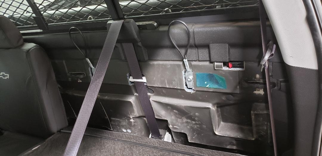

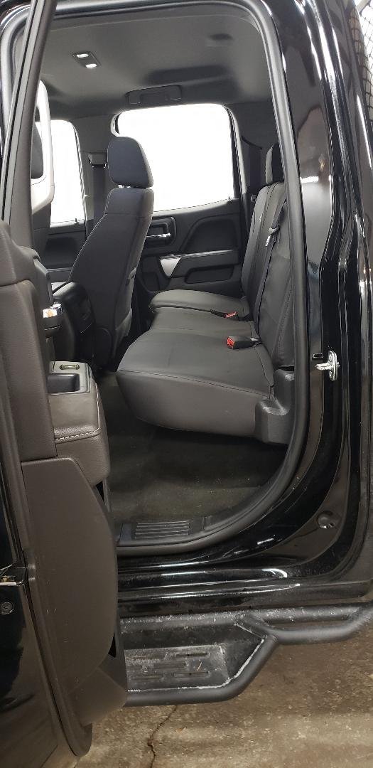

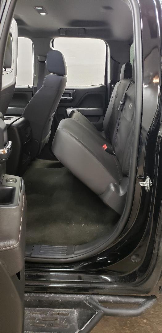

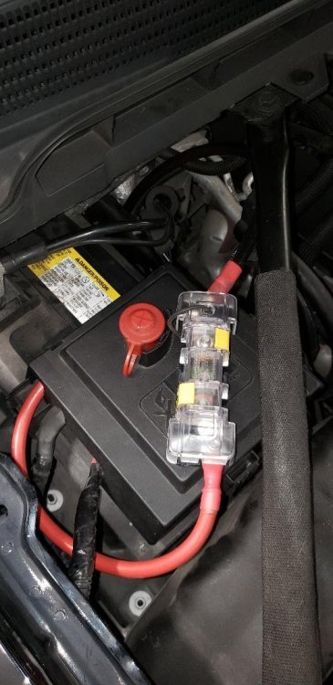

  3. Hey, how you guys doin? I have been working on my 2017 Silverado GMRS and CB install when I get a chance and I've got most of it done. I have shown above how I mounted the third brake light antenna mount. I have about 50 pictures of the install including running the battery power under the truck and up into the rear seat area, modifying the back of the back seat to fold down, the fabrication of a steel panel to mount the radios, fuse block, relays and wiring for strobe lights, all going behind the rear seats. The two radios I picked, (Midland 575 and Uniden CB) both use cat6 wiring to control the radios from the microphones. I have removed the two 12v power ports in the center console and replaced them with cat6 jacks. So when the radios are not in use, nothing is showing. I work in an area where if there is something to steal in your truck, it WILL get stolen. So I have to keep my stuff out if site. The sound goes through the factory radio speakers, and I still get turn by turn navigation on top f the radio sounds. Here are some pictures of my finished interior and I'll work on more posts showing how I did it all. Paul.

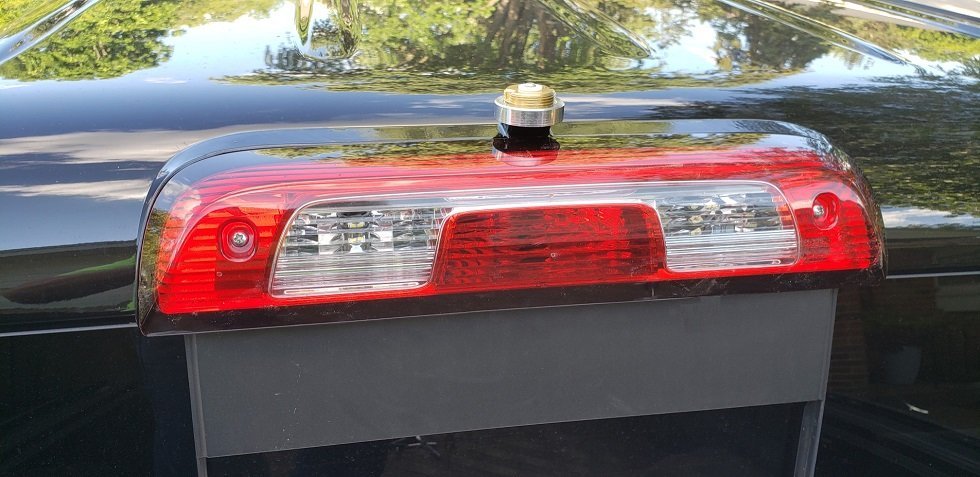

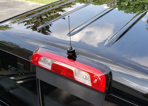

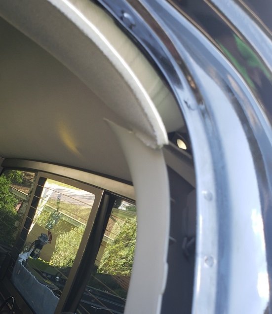

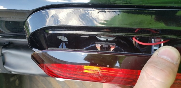

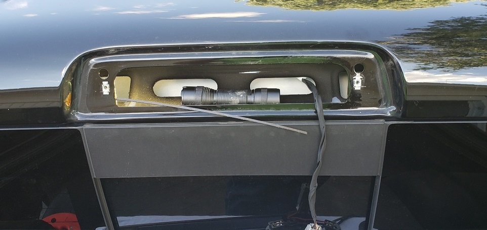

  4. Hello, I installed my NMO antenna mount to my 2017 Silverado third brake light. It went well. With an NMO mount you can change antennas quickly if you change to Ham or CB inside the cab. and a small rain cap if you want to take the antenna off for any reason. First, I removed the one screw from the top of the C pillar, 8mm, and took the two screws out from the pass rear grab handle, 7mm. Then I pulled down the weather stripping, just from the rear top corner and that let the headliner and top of the trim come down just a little. see pics Outside, put a rag over the gap between the bed and the cab in case you drop a screw it wont go far. Take the third brake light out, T15 torx. The instructions say to route the coax along with the light harness. but there is a more direct path immediately to the side of the light that runs horizontally from one side of the cab to the other, door to door. see pics You can see directly from the door to the third brake light, it's less than two feet. I ran a fish tape through and taped my coax on and pulled it through. The original brake light screws are used to hold the NMO antenna mount in place and they give you two new screws that hold the brake light to the antenna mount. There is an additional clamp that is already attached to the mount that pulls the top of the mount center to the top of the cab. Everything seems secure and tight and even though there are gaskets on both sides of the mount, I put a bead of black latex caulk around the top edge where the cab meets the mount just to be sure no water gets to the gasket. After installing my NMO antenna mount I realized that I didn't like the polished aluminum finish on the base of the mount so I painted that gloss black. Right now I'm using 50 watt mobile GMRS radio and the 462 MHz band only needs a short antenna. Unless you're looking for it, it's hard to see. I'm not looking to get a lot of range with this, it's only from truck to truck communication.
