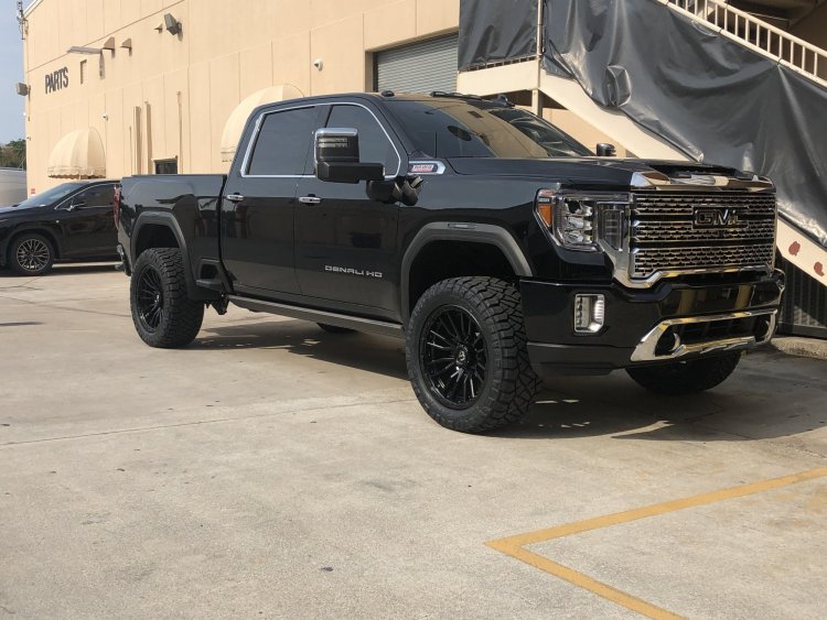

  3. Just installed the Cognito kit with UCA and Fox Shocks. I am measuring around 42 Inches all around from the ground to the fender opening. Is that what you all are experiencing? I have the same wheel and tire setup coming as firstascent. I wasn't sure if I should bring up the front a bit as I do have helper bags going in to help with my 5th wheel. I want to make sure I have clearance for the wheels and tires.

  8. Looks good Doozer!! That's why I come to this forum!! Honestly feel I would be settling with the 20's. To answer the above question, I do not want to cut my frame. I also wasn't a big fan of ordering wheels and tires finding out they don't fit and being stuck!!
  9. Hello all, I have a 21 Sierra Denali 3500 HD SRW. I have been going back and forth between doing a Level Kit or a 4 Inch Lift. I would prefer the simplicity of just doing the level but am being told I just can't run the wheel and tire setup i want. I am looking to run a 22*10 -18 Wheel with a 325/50/22 Tire. I cannot just run a 35*12.5*22 because I cannot get the proper Load rating as I am pulling a 5th Wheel. I am being told by Cognito/Kyrptonite as well as a reputable shop that the max wheel/tire I can run on a level without seriously cranking the keys would be a 20*9 +1 with a 295/65/20. I just feel I would be settling with that set up. Drivability/safety is important to me. I appreciate the feedback
  10. I am looking to run the exact set up. I have a 3500 Denali and want the same wheels and same 325/50/22. I am installing the cognito level kit with UCA. I am being told but multiple sources that this will not work which is certainly frustrating since you have been running the fitment. The last thing I want to do is order everything and it doesn’t fit. I am being suggested running a 20*9 +1 with a 295/65/20. I would prefer your setup. Any words of encouragement?
