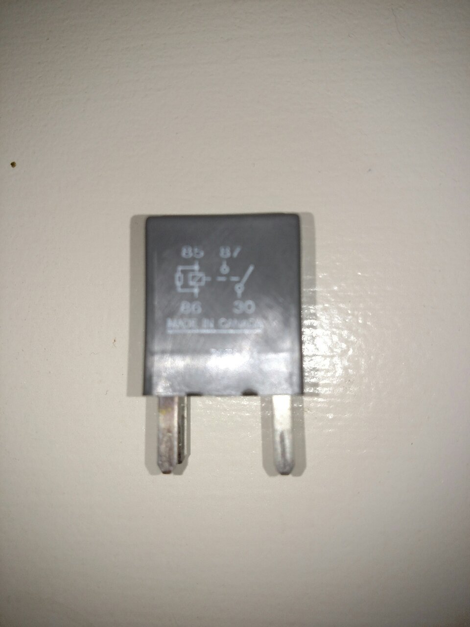

  1. I'm changing out all my power and accessory relays. The original is an OMRON 5510-0329 STSP NO relay. This seems difficult to find. However, there are plenty 5 PIN STDP relays that unenergized connected to the 87A pin number 5. Does anyone know of a reasonably priced replacement for the original or if the 5 pin is compatible? Thanks

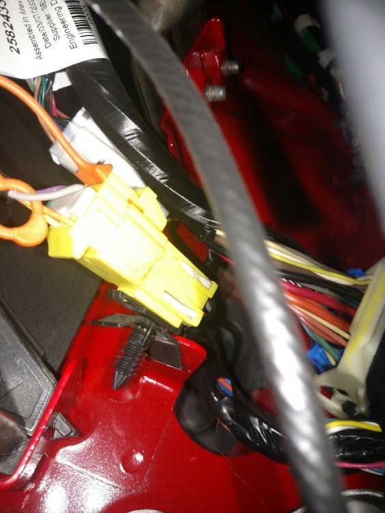

  5. I am proceeding with due caution! The airbag light comes on intermittently, and comes on when parking brake on my Hummer H3 is released. I found this GM Service directive (Service Airbag - Have Codes - Ask the GM Technician - GM-Trucks.com (gm-trucks.com)) and tried compressing the described connector. The airbag light went off immediately. The directive indicates "Disconnect and reconnect the IP harness to inflatable restraint module connector C221 or C222 THREE times. <LI type=1>Clear the DTC and road test the vehicle" It appears the problem is the connector is anchored to the same bracket as the parking brake stop. When the parking brake is released the connector is shocked and air bag light is fired. I compressed the connector and the airbag light went out. I want to do as recommended in the tech brief, but I want to do it safely and without damaging the connector.
  6. I have never seen a connector like this. Can someone explain how to disconnect with harming it? Thanks
