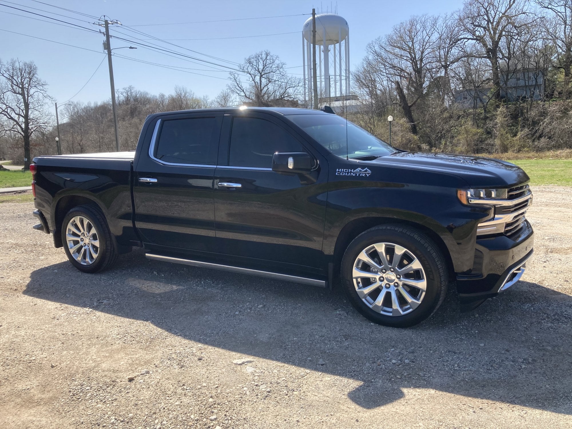

  1. Here's the '21 from the same angle as the '19.

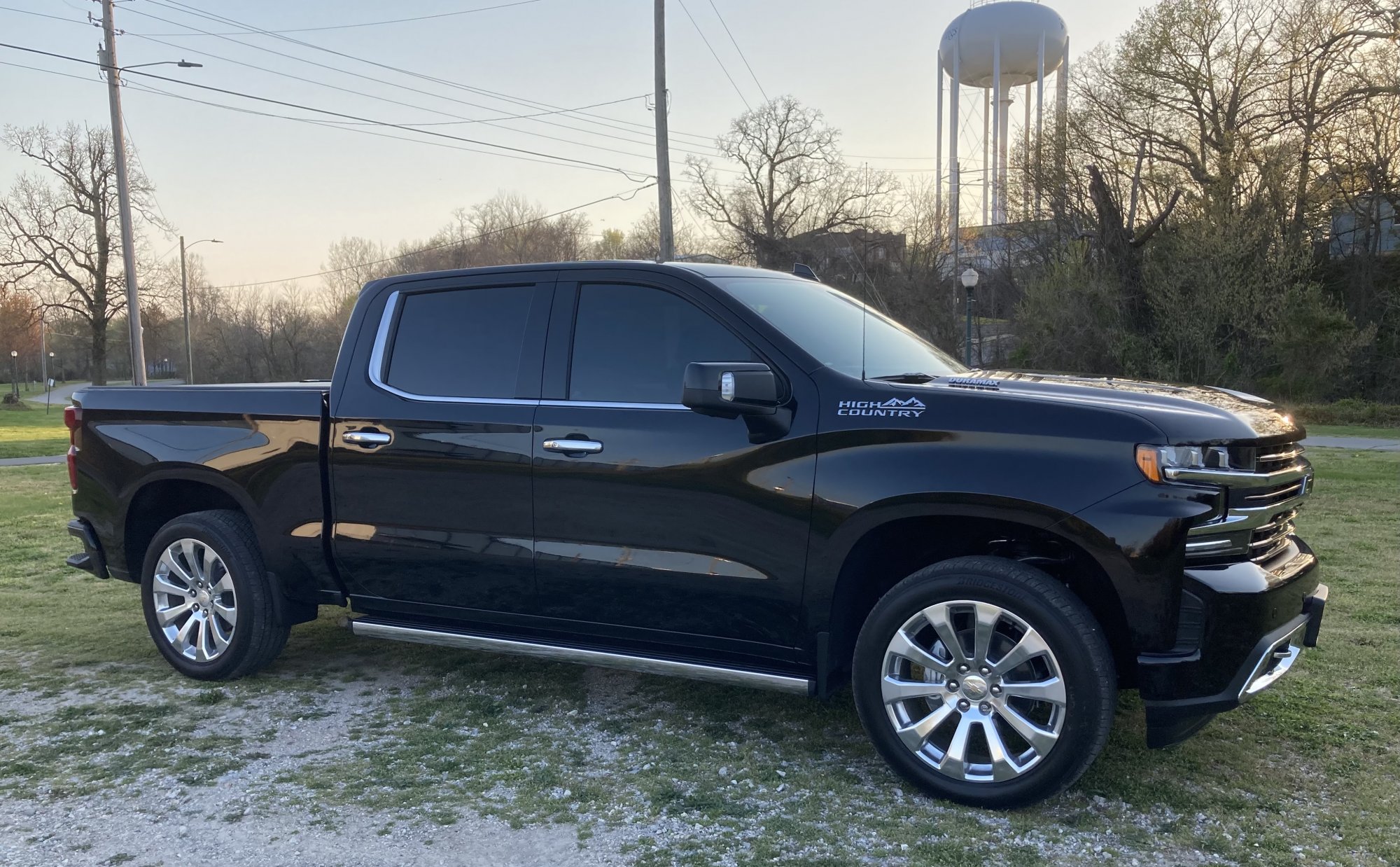

  6. I'm new here and just tried to search for this topic, but didn't find anything so here goes. I just bought a 2021 High Country 1500 4wd with the 3.0 Duramax and Adaptive Ride control. I want to lower it 2" all around and the kits I've seen so far say will not fit with adaptive ride. Can anyone explain the issues of lowering a truck with ARC and what it might take to lower one? I had a 2019 High Country 6.2 4wd and lowered it as soon as I got it and really liked the look. A pic of the 2019 is below. Thanks
